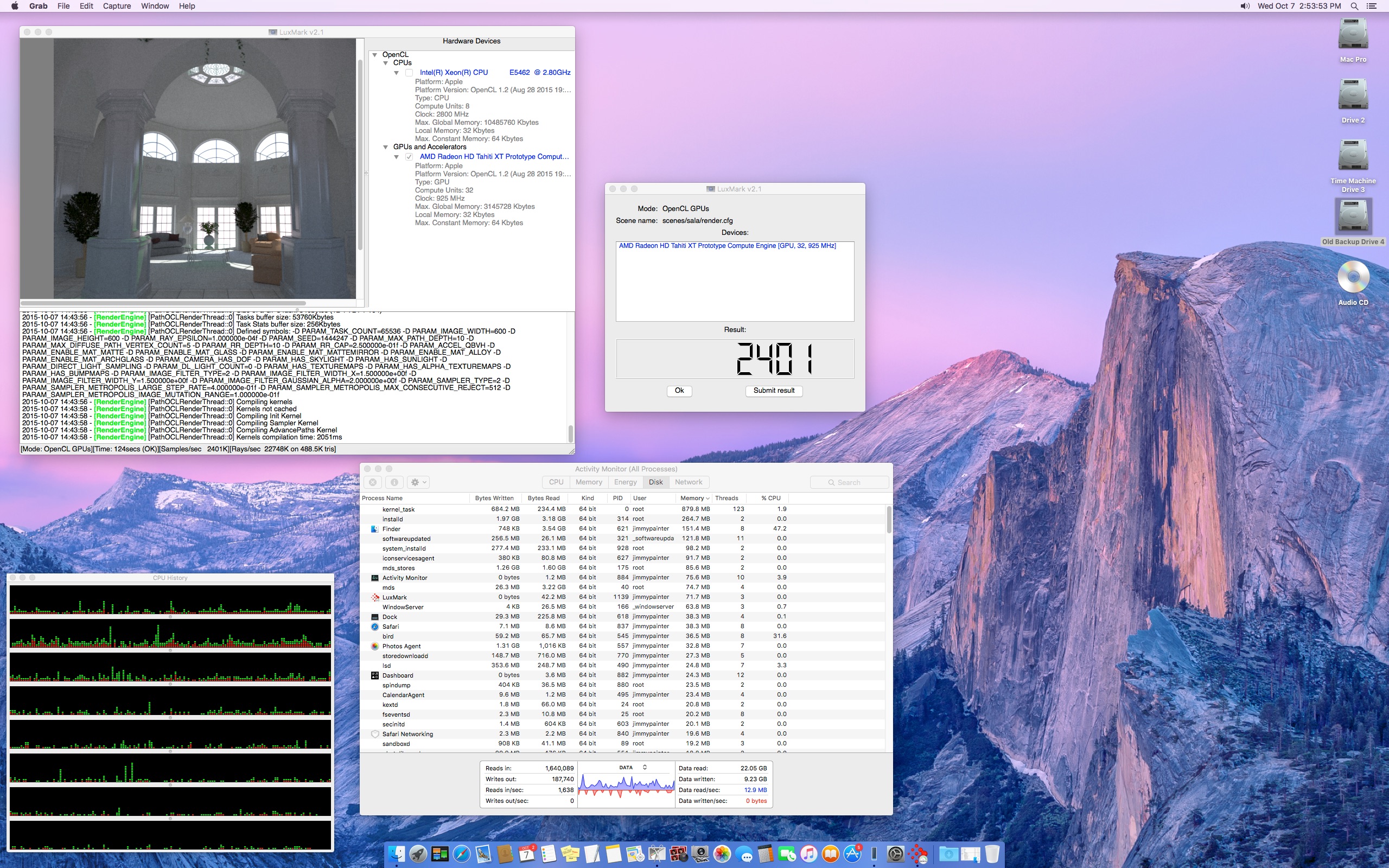

I am running a Mac Pro 3,1 with a 7970 and it screams. Especially for $500 + $150 for used 7970. I kept the original Video card for boot screen and the Lexmark Sala score I am getting is right there with a nMPro D300s.
