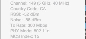

I just got a new Rocket Hub (MF275R) for mobile internet, and it works beautifully... 🙂
The only confusing part is whether I should be connecting to 2.4 GHz or 5 GHZ wifi.
The 2.4 GHz setting seems to have higher SNR and slower transfer speed, yet the 5 GHz setting has higher lower SNR yet higher transfer speeds.
My Macbook Pro (2011) is used for web browsing, email, the odd video (Youtube) and Backblaze backups, etc.... Nothing really intensive that I can tell.
Which should I connect to... the 2.4 GHz or the 5 GHz...? (I attached the screenshots with info below).
Thanks, IAN.

The Rocket HUB (mobile internet) is either across the room (8ft), or I can place it within 2ft of my Macbook. The HUB is using LTE to the cell towers and I have a strong signal, so I am getting 40-50Mbs DOWN, and 40Mbs UP.
I wasn't aware that the MB would choose the fastest frequency when it has a choice between 2.4 or 5 GHZ
I realize that if I place it within 2ft of my MB, I may as well just use ethernet since I am using a Hengedock docking station. I presume ethernet will be the best of all the three options, and offer me the best speed & reliability. I can use the wifi portion of the HUB for iPhones etc....

View attachment 631054 View attachment 631056

Hi, that appears to be a misprint, as the web interface only shows 802.11 bgn, and no ac anywhere..... 🙁
Maybe my iPhone6 has AC, but I seriously doubt my 2011 MB Pro has any 802.11 ac
Probably a firmware issue!?

For now, I have found that the Rocket Hub (LTE mobile internet) has a better signal when placed next to my Macbook, versus being on the other side of the room. Since it is so close to my MB, I decided to use the Ethernet port (Cat5e cable) to connect it directly to my laptop.
I imagine both will be fast & solid, the 802.11n & the Cat5e Ethernet connection.
