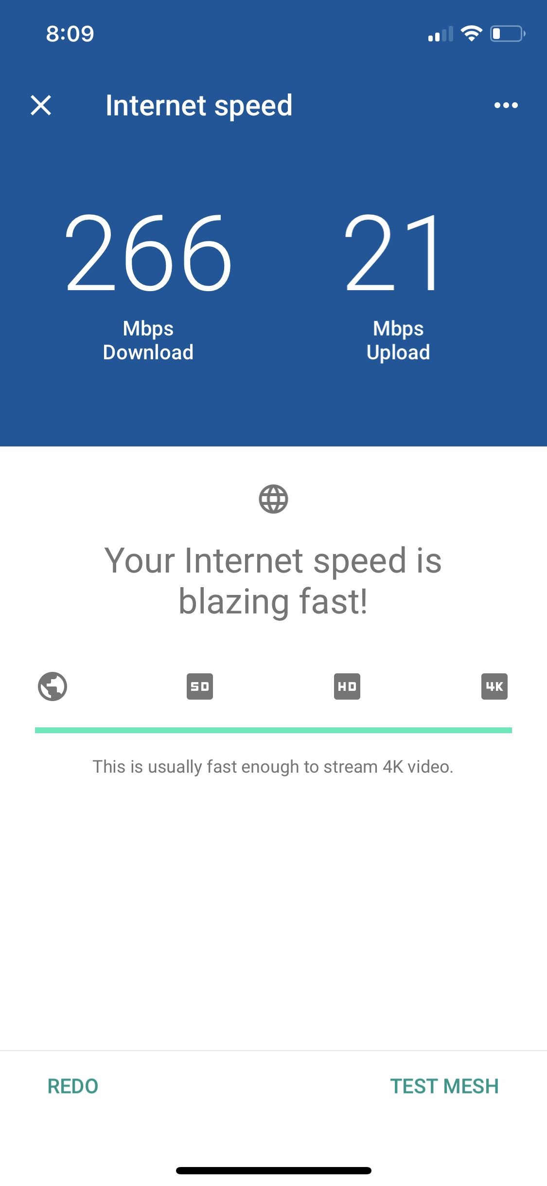

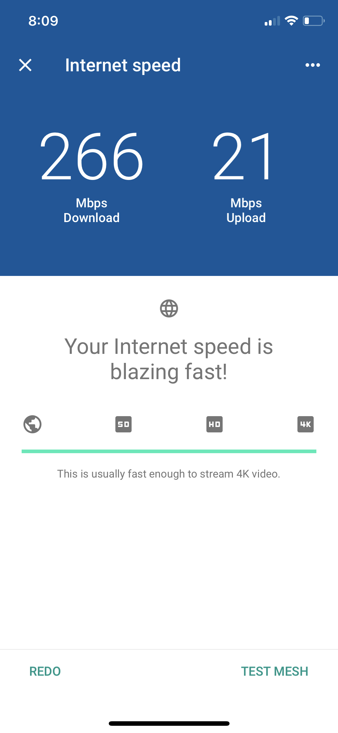

My google WiFi app is reporting slow speeds. I pay for 300/20. It reports 40-100/10. When I use a speed test to test it...it looks fine. I just had ISP come and test it and my modem shows over 300/25. Which to believe??

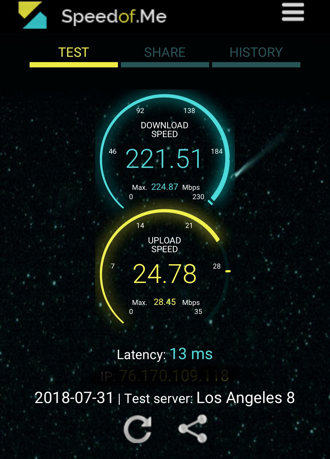

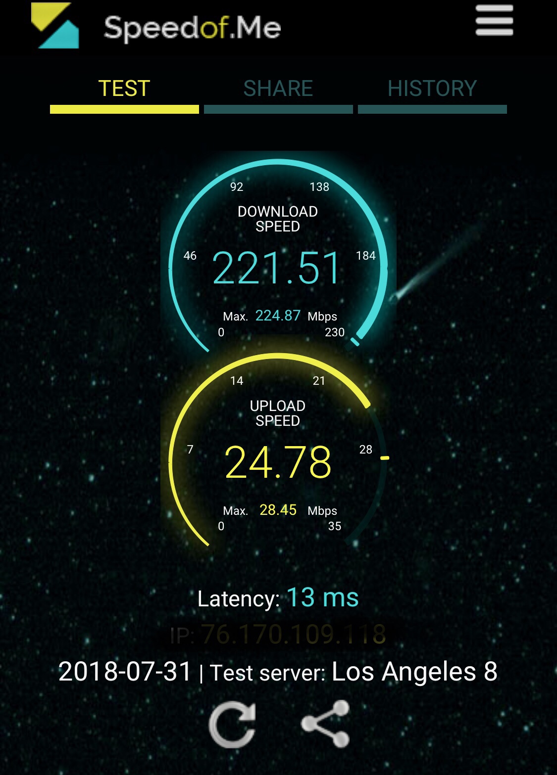

I used to use speedof.me, but I've found it is consistently showing slower results. I think an HTML-5 based engine just can't saturate my pipes.

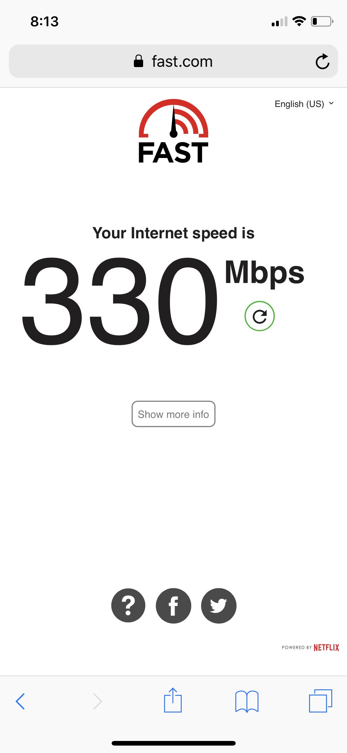

I use fast.com most of the time. I like that because it connects to Netflix servers, it can't be tricked by your ISP as easily.

My isp came and the modem is great and the speeds provided are greats. Seems to be my google WiFi network that is slow. I re set up the network from scratch and it is a little better but not as good a it has been.
224Mb/s of throughput is pretty good for 802.11ac.

Right. But the WiFi speeds se to be an issue. They were faster and more stable previously. Sometimes it goes as low as 40 down. But then other sites will show higher speeds.
I am going to replace the Ethernet cable tomorrow to see if they helps.

So, the speeds are much better than they were.... I replaced my Ethernet cable yesterday.
Still odd to have the discrepancy betweeen the speed tests.
