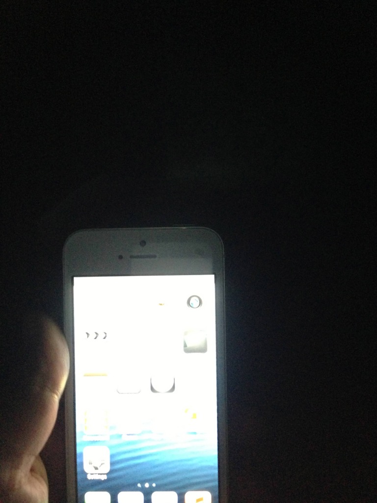

Please answer the poll. I have got my white iphone 5 replace 2 times.. But every time their is light leak issue in the unit..
Poll? What poll?

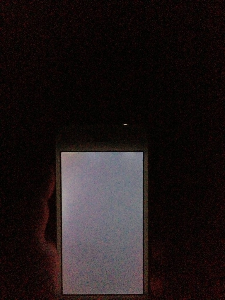

wanted to create a poll to see how widespread this issue is... as i have already replaced my iphone 5 2 times and still i see the issue of light leak near the power button..
but for some unknown reason, I am not able to create a poll... i don't see a option under Thread tools to create a polls.. 😱
Cant tell if its just the bad camera you're using, but seems like there's pink light bleed all over that screen.

I used iphone 5 to take these pics.. 😛

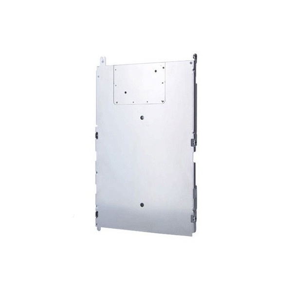

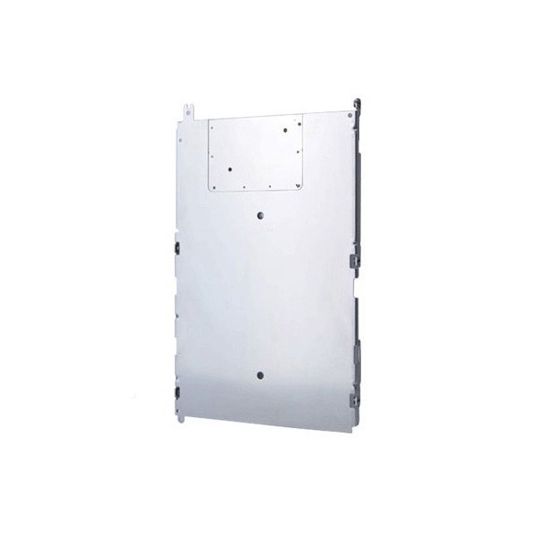

Can I repost something I put in another thread? Well, here goes...
On closer inspection of the "gap", the light leak is coming from the LED itself. On the back of the LED there is a metal plate (see image). Close to the area where the light leak was when looking at the phone from the front, the metal was not sealed against the LED properly (a 3/4mm gap) so light shone upwards towards the power button. There was no leakage around the rest of the metal plate. I placed a small amount (5mm wide) black tape over the leak. Now when sealed up there is zero light leak seen. DIY My phone is pristine and I did not want to return it again because of the leak, so it was easier to do it myself. As I said before too, it's easy to reseat the screen in that corner first so the gap is reduced anyway.
