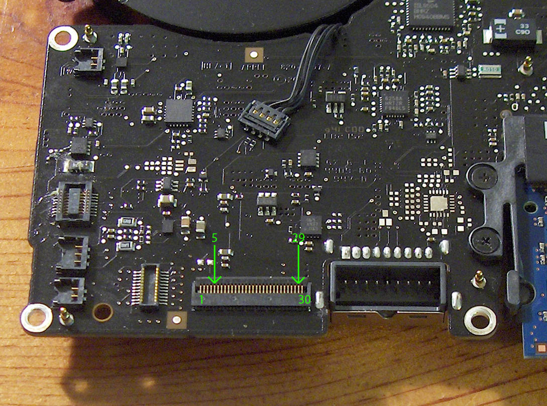

For anyone coming across this thread with a 2009 White Macbook.
Just connect pin 5 to 29 of the Keyboard Ribbon Connector as shown in the picture. From what I can tell connecting the wrong pins causes no damage. Which makes sense since keyboard presses connect the various pins together.
This is only tested on the Late 2009 Polycarbonate Unibody Macbook. I would assume this works on other Unibodies with the same keyboard connector. But do not know. Anyone with other Macbooks or Macbook Pro please chime in if you have to try this and it does or does not work. If not please find the correct pin out if you are in the situation of not knowing if the power button or Motherboard is bad. Given how well the keyboard is sealed if the Macbook works for quite a while after a liquid spill then suddenly dies there is a good chance for corrosion of the keyboard.

That's exactly what i was looking to do, thanks. I will try this tomorrow and post back my results.
Older MacBook isn't really worth fixing. Also don't short those pins like he says...there are actual pads on the logic board for that, they are also located near the fan. They usually say pwr near them. You may want to do some research into that.
