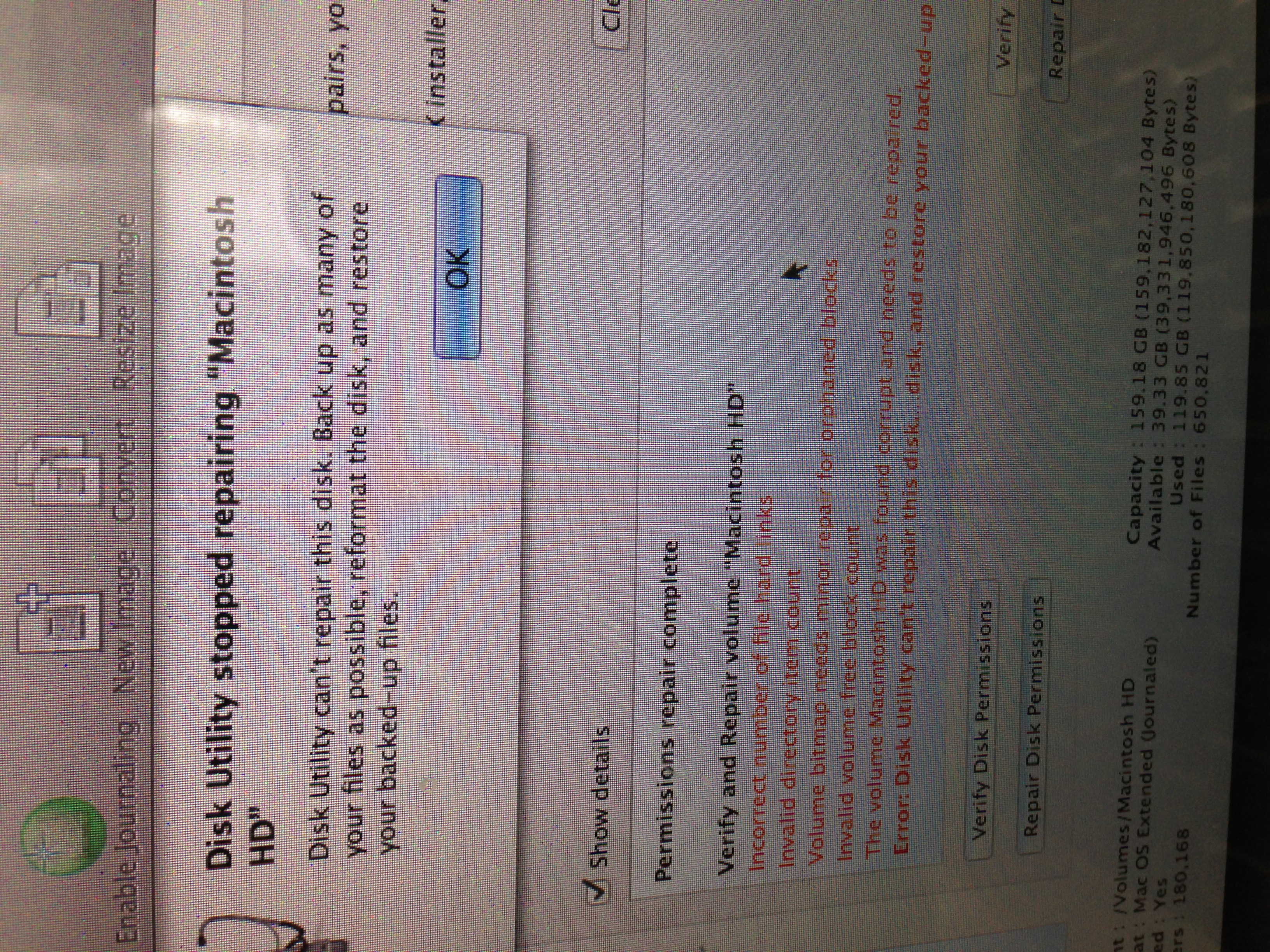

Hello. My MacBook Pro won't fully boot up, it hangs on the chime screen. You'll note from my attached pic that a repair didn't work and it recommends that I format and start over - sounds daunting,is it???

Do you have a back up of your files since you are away from home?
if you are running 10.7 or 10.8...
If there is a viable network connection that you can see and access? Here is what to do, when you reboot your mac, hold down the option key. Eventually a few icons will pop up. One should be your existing OS install, the other should be your recovery partition.
From there? Follow the prompts, type whatever you need and and install away.
Couldn't unmount the disc
Hi, now at home and tried to erase the disc and start over via disk utility but, got a message saying Volume Erase failed with the error: Couldn't unmount the disc.
Is it game over for my HD?

Are you using Disk Utility when logged into OS X? If you are then this won't work.
You will need to boot up your machine holding the alt button.

Select recovery partition, and then under utilities select disk utility.
You should then be able to reformat the partition.
Most likely a bad HD, sorry. You'll need to get it replaced, any Apple authorized service provider can do it. You can upgrade your HD size at the same time, or go for an SSD, though that would be significantly more expensive.
