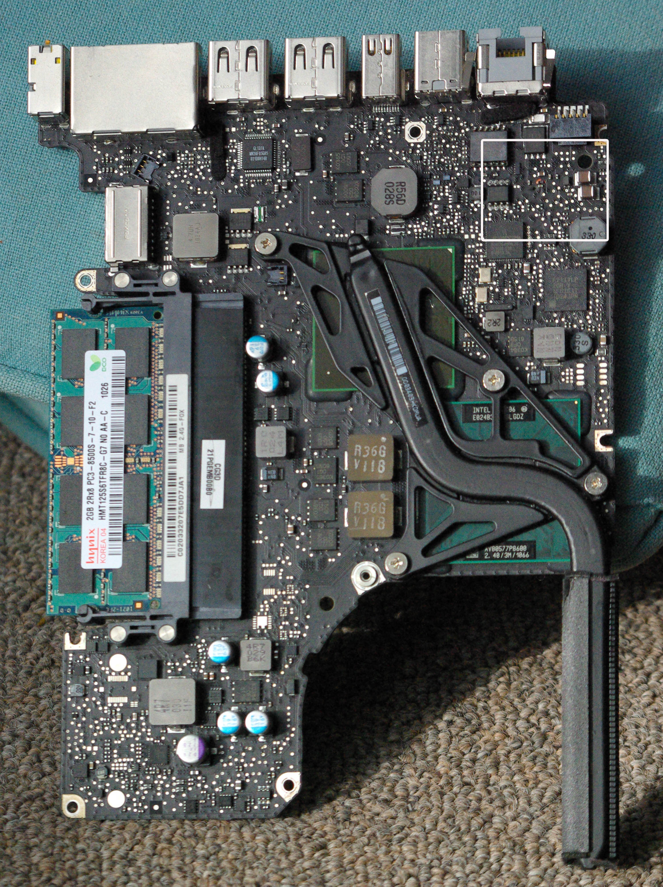

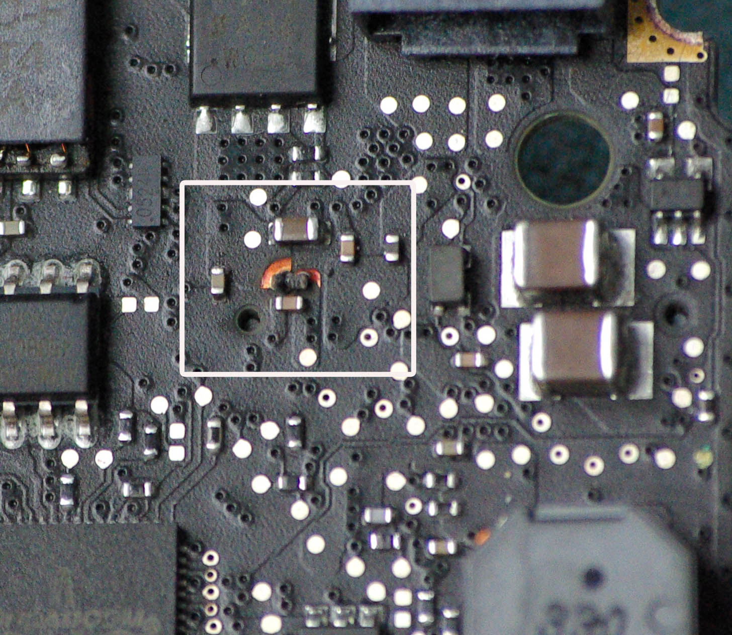

I think I've found the problem. Probably unfixable (by me!) but maybe someone could give me an opinion? As you can see - something (resistor) has fried. It's in the area of the LVDS connector and on the other side of the board near the DC in socket. It has occurred to me that replacing this burned component (even if I could) may not fix the problem if the reason it burned is unknown.
Any input greatly appreciated!
