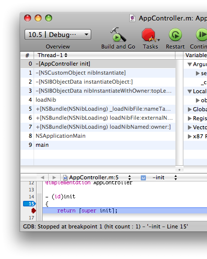

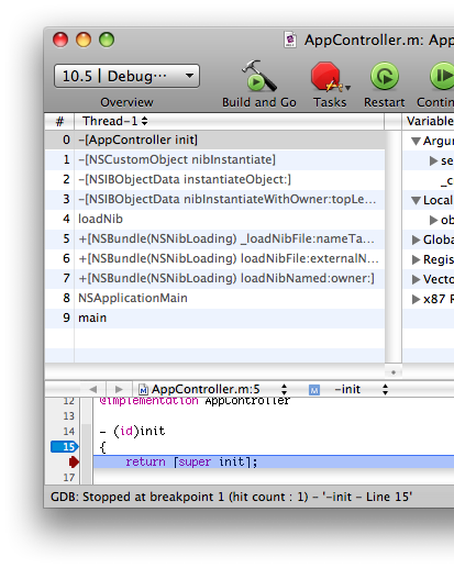

1) Who calls this init?
The nib loading process calls this. If you set a breakpoint at your init method, you can see what calls it:
This is documented here: The Nib Object Life Cycle
