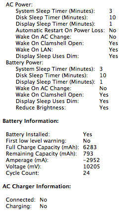

I just looked at the battery meter on my MBP, and it's saying I have 17 minutes left. I had it plugged in and fully charged until I left for class. I have been surfing the net and typing in Word, but that's stuff I do in class everyday. Usually around this time I have about an hour and a half of battery left. I've been using it for just over an hour right now. Could it be the fact that I downloaded a few podcasts and then closed iTunes? I wouldn't think that it'd drain that fast because of that. Is it supposed to show a negative amperage like that? Curious...

Calibrated it about a month ago. It shouldn't need to be done again so soon, should it? It was at 100% health and 100% charge when I left for class. Luckily class got out at about 8% left.

I took a look at the battery stats again last night, and the amperage was down to about -3,500. When I first turned the computer on it was about 98% charged and showed I had 2 hours and 7 minutes of life. I moved those video podcasts from iTunes to my iPod and it drained from 98% to 94% (not that unusual) and the expected life dropped to about an hour and a half (again, might not be unexpected as I was just moving stuff causing a bit of load on the HDD). I'll check out everything when I get off work today and see what I can come up with.
