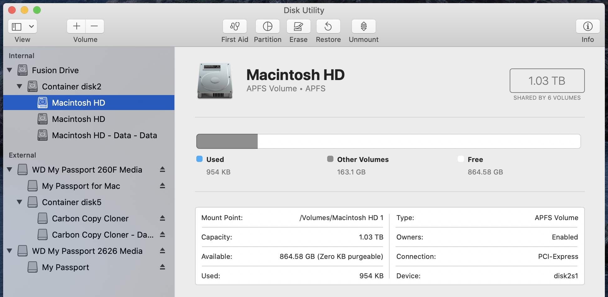

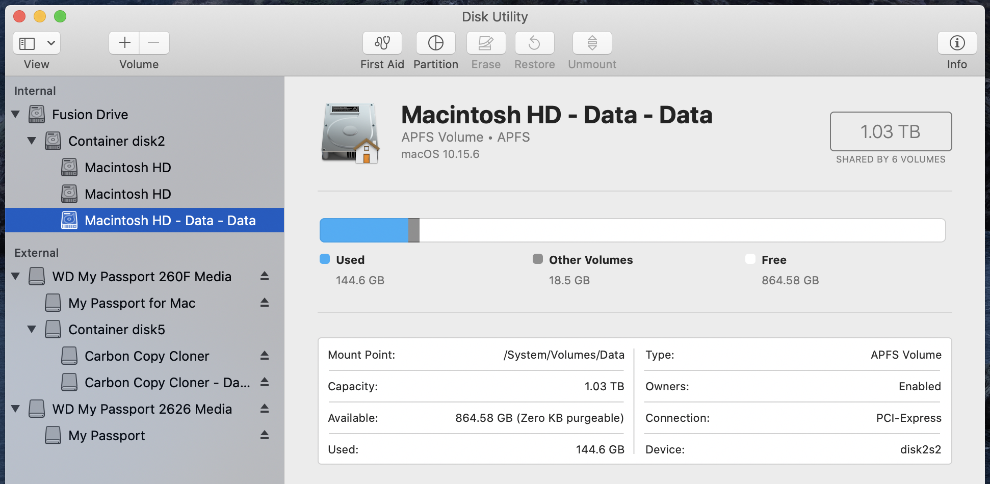

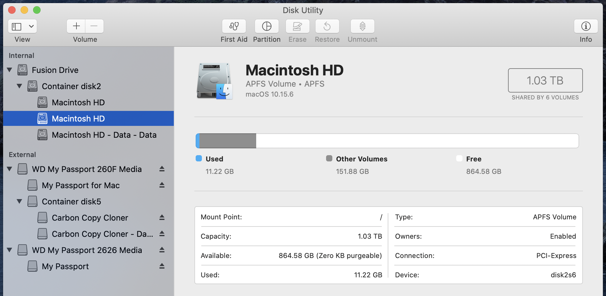

I have just bought a new iMac (OS Catalina) and installed all my previous files etc from a clone on an external drive which was from another older iMac also OS Catalina. All is working fine except I now find I have two Macintosh HD icons on my desktop. In Disk Utility I then see I have two HD's and one HD - Data - Data. Why is that, and how do I establish the correct one on my desktop and remove it?
That's the point - which one do I remove? I understand the difference now between HD and HD - Data drives, but ignoring the data drive why do I have two almost identical HD drives? I repeat I have 2 HD drives and one HD -Data - Data drive showing in Disk Utility.
Can you post a screenshot of Disk Utility.app?
Make sure to select View -> Show all devices prior screenshotting
I hope this shows all three drives.

You should be able to safely delete the Macintosh HD partition that only contains 954kB. You go to Disk Utility, highlight the top one, go to edit and if the "delete APFS volume" is available, you should be able to delete it safely.
If you are successful in deleting the top one that is only 954KB, You can rename the "Macintosh-Data-Data" to "Macintosh-Data."
Very strange. You could probably delete the 954KB and rename the drives the way they should. But to be sure, I would make a backup first.

I unmounted the smaller of the two, and the remaining one (Macintosh HD - Data) appears on the desktop without the "- Data" suffix.

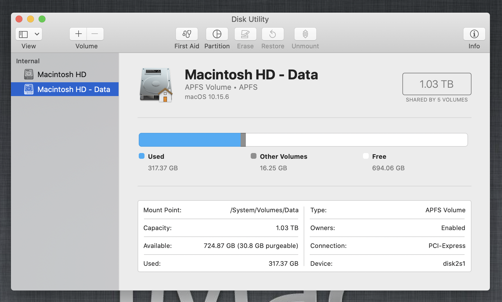

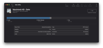

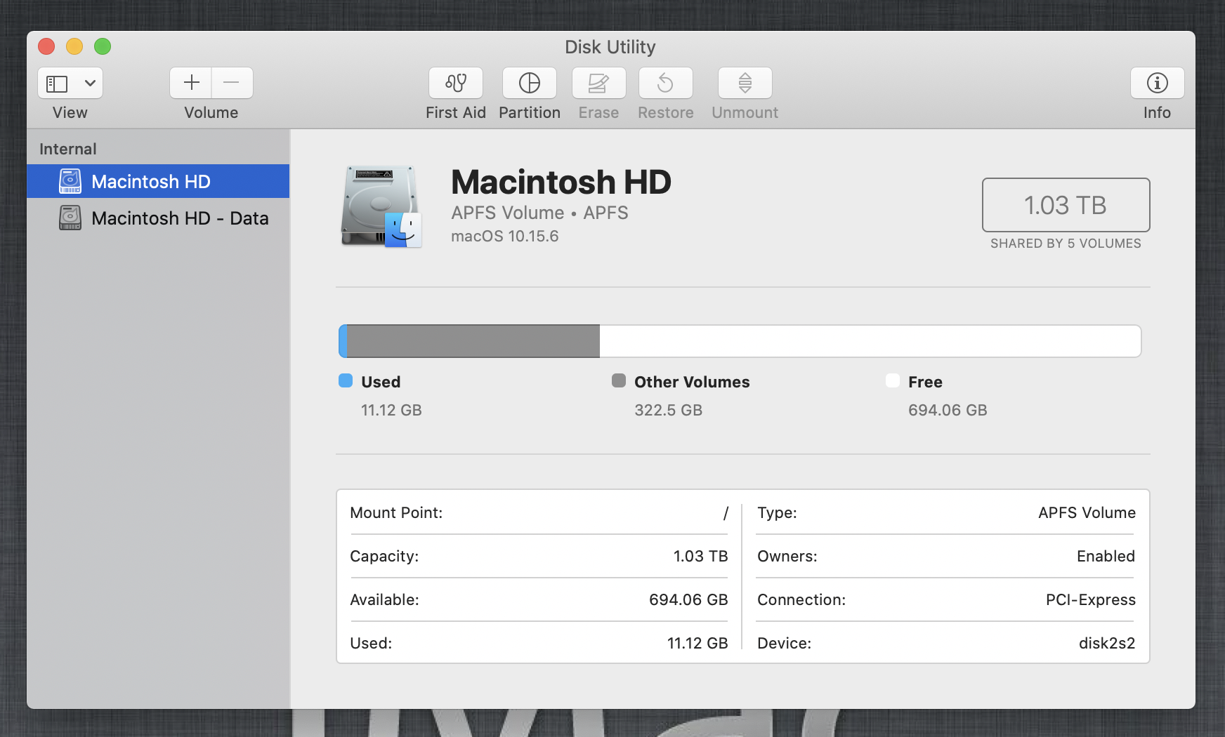

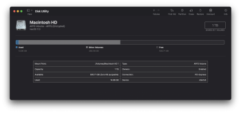

So your drives look like this (see attached pics)

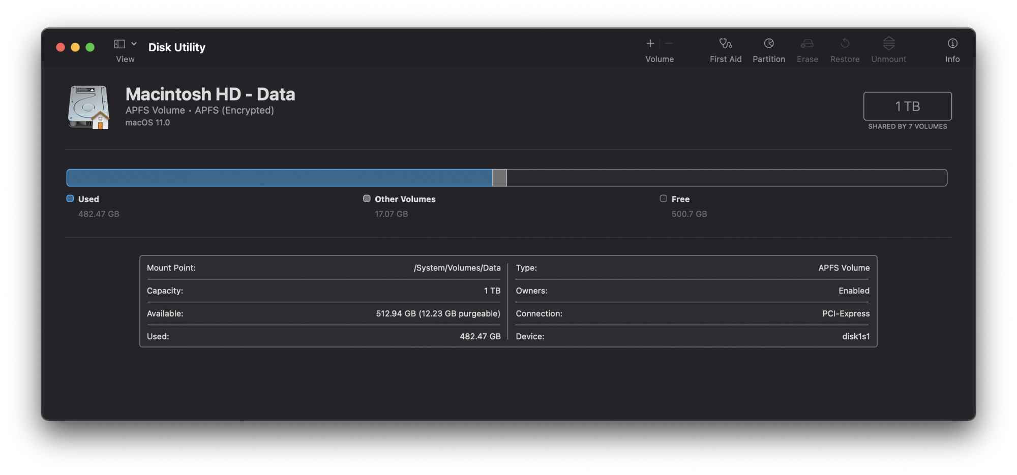

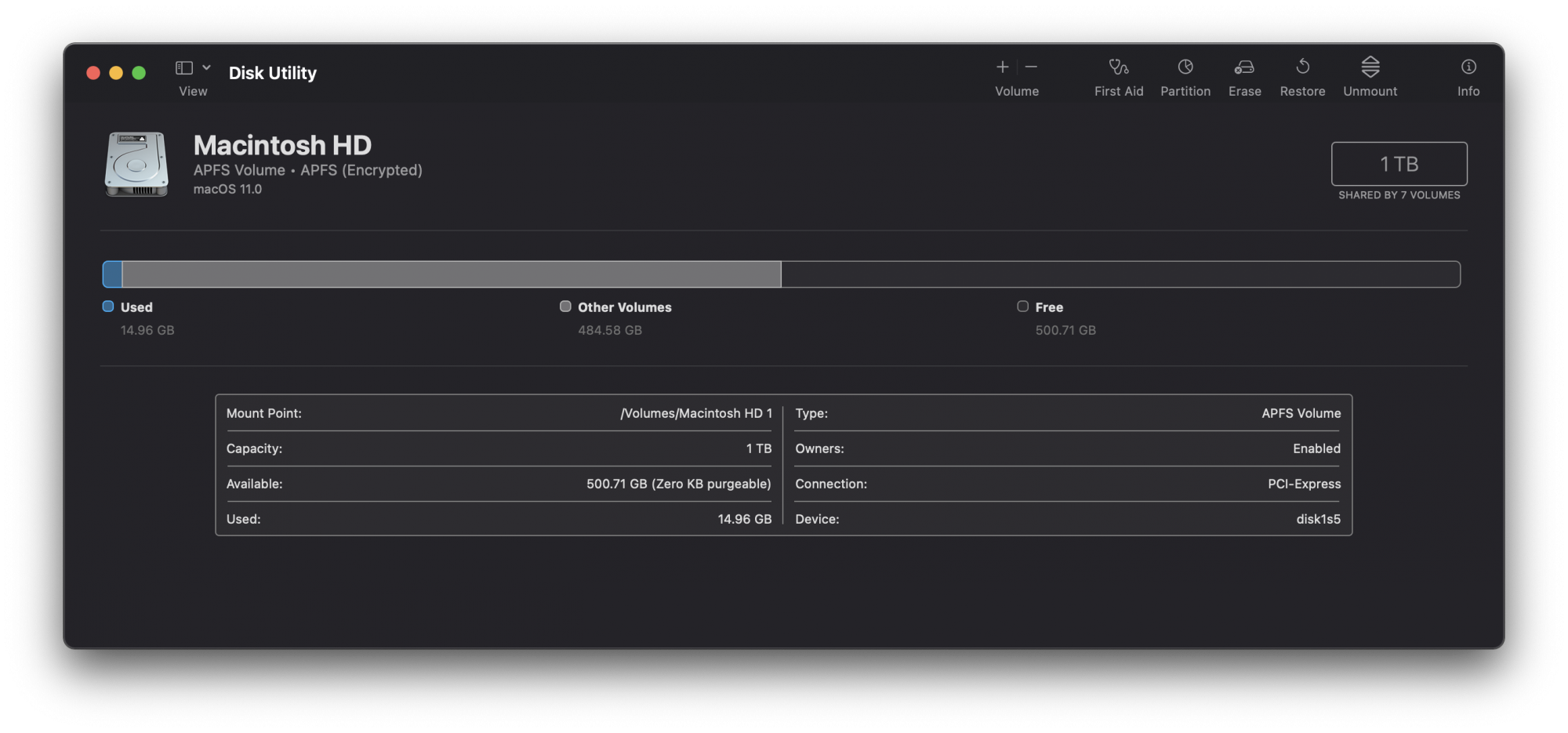

Well, a bit different as I am running Big Sur. I just re-mounted disk1s5. But it doesn't have to be mounted for the system to work.
I realized I confused some people. I don't have the 3-slices problem. I was just commenting that you can unmount the non-Data drive.
