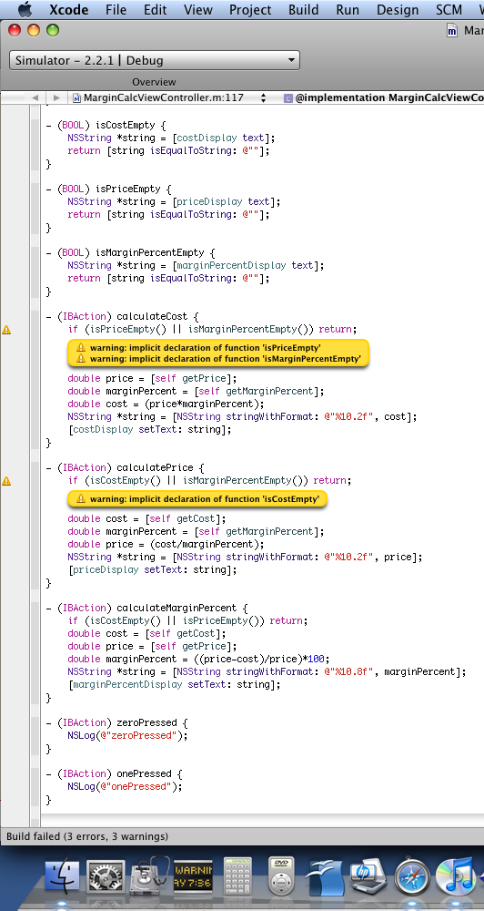

Hi,
I'm getting the warnings shown in the picture below, but I don't understand why.
Can somebody help me to understand how to rectify this problem?
-- Kaydell 😕

Try using:
Code:
 [self isXXXEmpty]
instead of
Code:
 isXXXEmpty()

OK, I Understand
OK, I guess that what I was thinking was that I could use C inside of Objective-C, but I realize now that the problem is that I defined the methods in Objective-C, which makes them object-oriented and then I tried to call them from procedural code, written in C.
Thanks for your help. I'll try to find a forum that is oriented more to beginniners in Objective-C.
