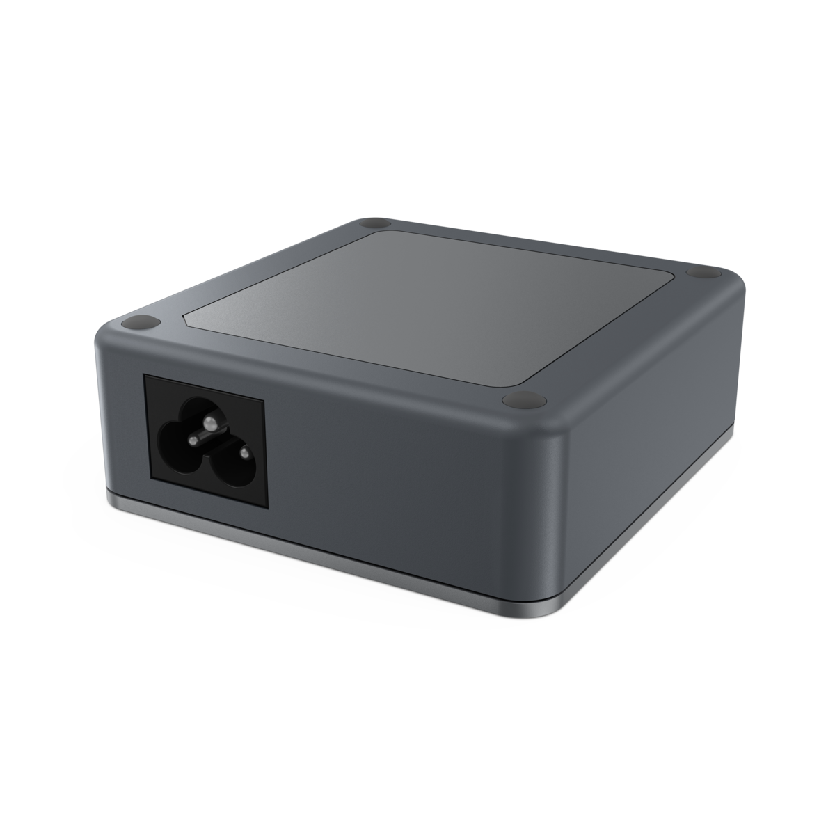

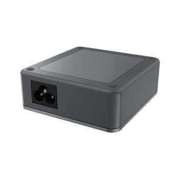

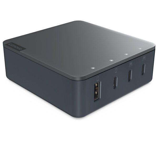

It's a matter of cost. Most higher quality chargers will be 3 prong for safety.
This 130W from Lenovo is a good example.

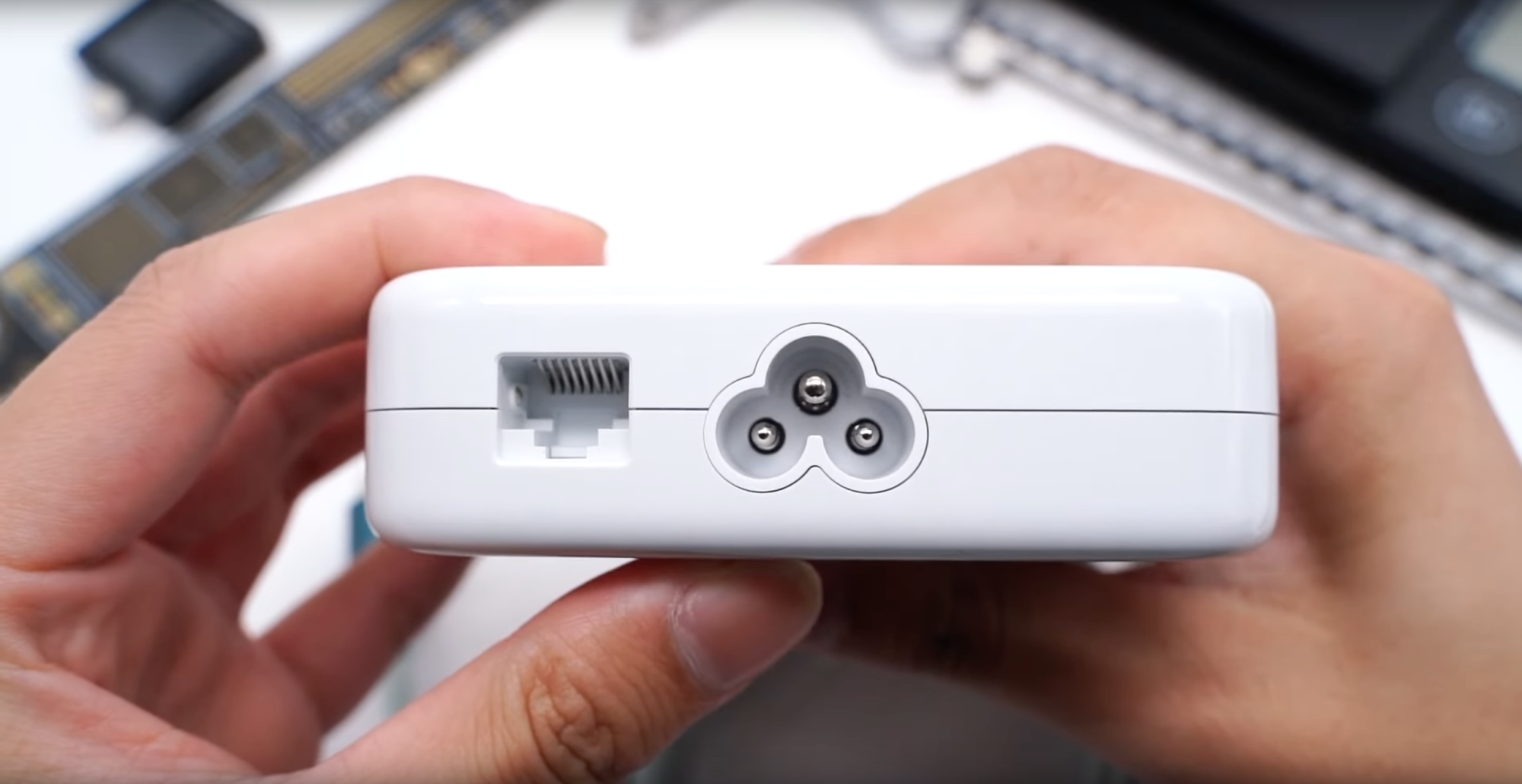

If you want to kid yourself and say, "it's a DC device, it's no safer with 3 prong," that's fine. But for people who want facts, here's what Apple includes in the box:
  • Apple TV - 2 prong
  • Mac mini - 2 prong
  • iMac - 3 prong
  • Mac Studio - 3 prong
If 3-prong weren't safer, Apple wouldn't be including it with more expensive products.
