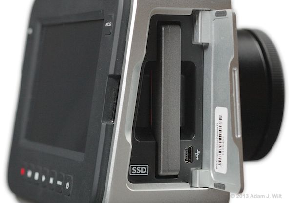

blackmagic cinema cams use proper SSDs
Vastly higher data rates, but in return you can "grade" and otherwise tweak the resulting video as you would a raw image from a still camera. Also a lot more expensive... Their cheapest cam uses SDXC cards, but it's only 1080p.

You're right, it can be much better to have an SSD, assuming weight and size are not an issue. Of course these solutions (such as BM and Atmos) costs thousands. It was my understanding that this thread was about why cameras like the one you want (under $1K) didn't have these features.
You're right, it can be much better to have an SSD, assuming weight and size are not an issue...
As a blanket statement, it is NOT better to have an SSD. SDXC works perfectly well in our professional Panasonic AG-DVX200 at 200 megabits/sec.
Our Inspire 2 drone's X5S camera can record H264 4k to SDXC or 4k ProRes to SSD, and we usually use SDXC because its data management is more convenient. I have edited lots of 4k 300 megabit material from a Canon XC15, and it uses CFAST, not SSD. What's "better" is what works and is appropriate for the scenatio.
You are absolutely correct -- what does SSD have to do with the OP question and camera type?
Is the OP bothered by the 4GB filesize limit imposed by exFAT? Even the Sony divides its recordings into 4GB chunks.
I brought up SSD because I thought it an interesting curiosity. As a technical solution, it's verging on obsolescence (more expensive, larger, heavier) for no real gains.
