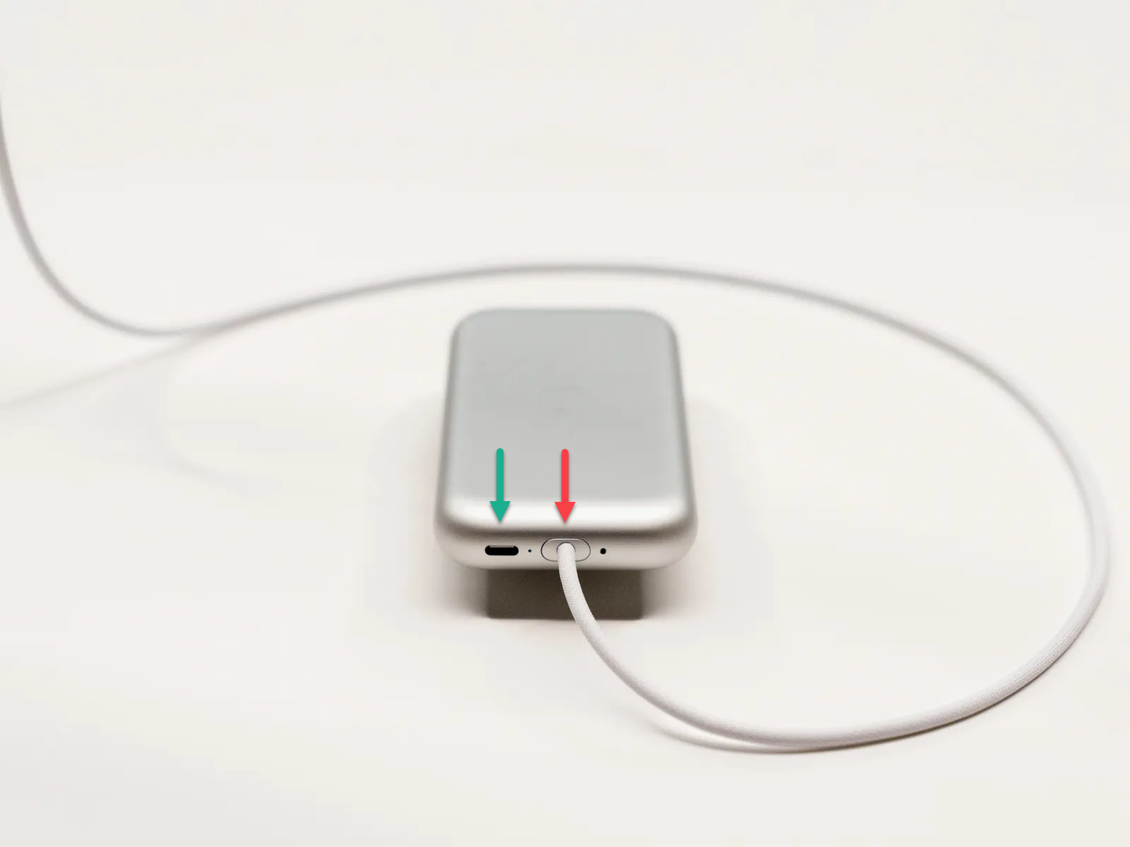

This is referring to the cable coming off the VP that connects to the battery pack for power OUTPUT.
The power INPUT to the battery pack is, indeed, USB-C.

That hole in the shape of a USB-C port is a charging port -- and I am pretty sure I heard that it was USB-C but cannot find it now.
I don't know about you, but it's clearly different shapes.
If one is USB-C (input), the other isn't.

That’s the part that goes into the headset itself. It appears the battery pack itself has a USB C port. So you should be able to just plug a battery into the the battery pack.

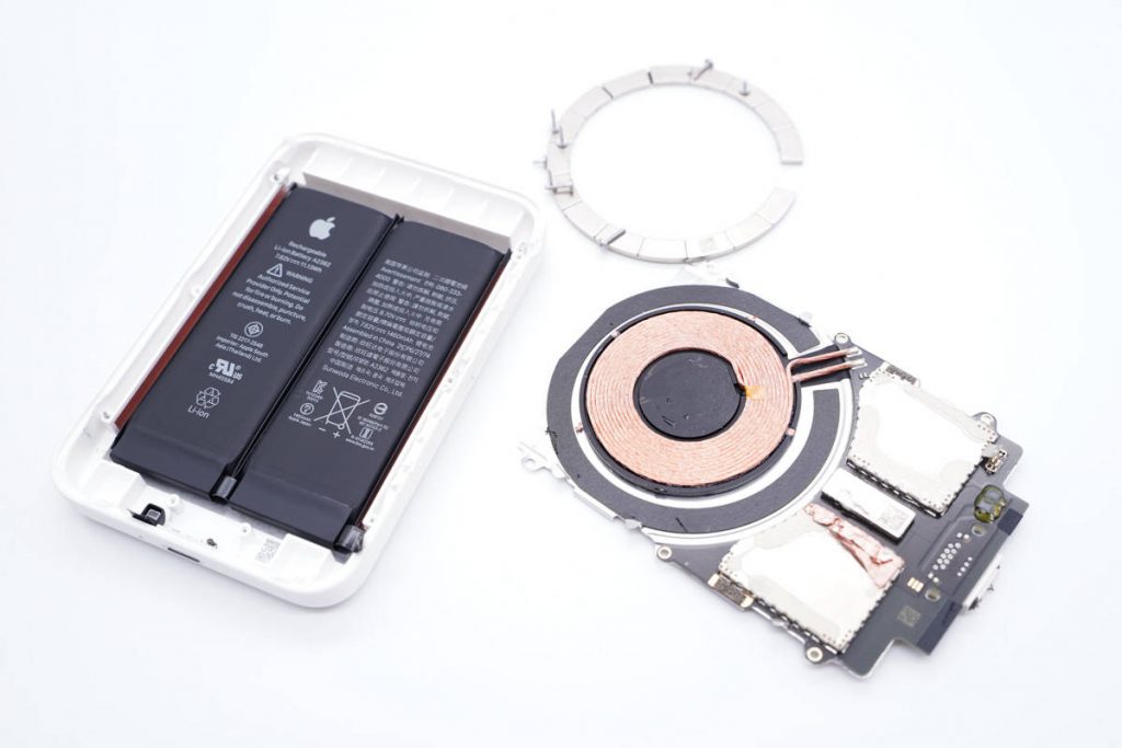

Those are clearly bare cells without a BMS flex attached. The inkjet printing suggests two pouches would be connected in parallel.
Why would you need two in parallel? Seems like a waste of space. A 2 hour run time suggests a 0.5C discharge rate. You don't need to deal with the complexity of wiring two separate packs together and charge balancing them.

You should ask Apple, they seem to love parallel designs. Here's the MagSafe battery pack for iPhone.
