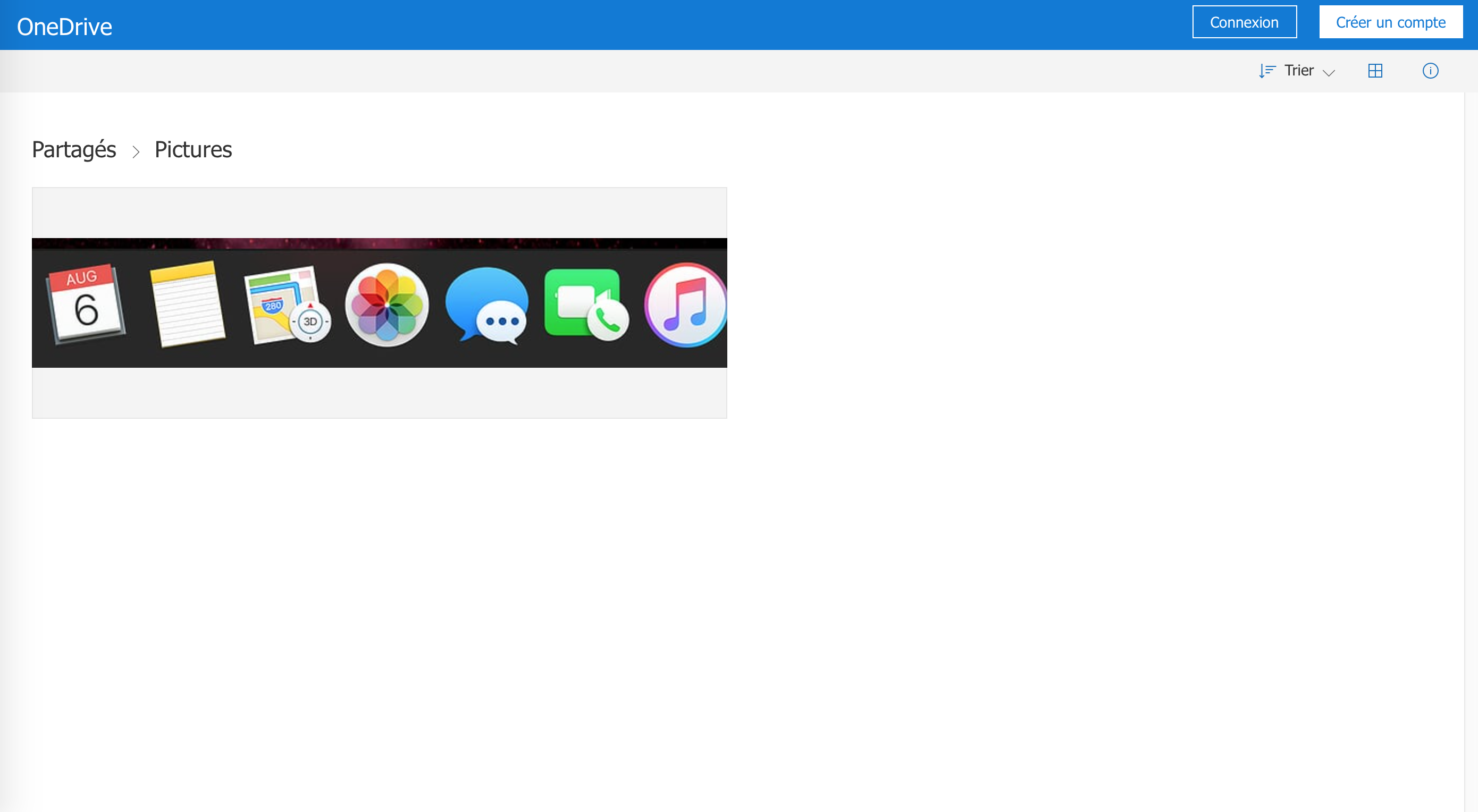

Here is what I see when I click on your link :
