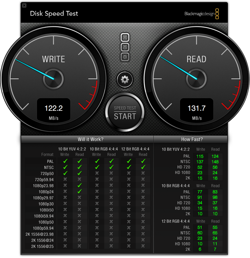

Late 2007 Early 2008 MBPro. SATA-1 (that might be the reason). Trim enabled. Out of box firmware.
Screen Shot attached...
S-ATA 1.5 Gbps (S-ATA I) is the reason.
You can use the following applications to benchmark the speed of your SSD, to see, if S-ATA 1.5 Gbps (S-ATA I) and not the application is the culprit:
And you can look into System Profiler (System Report on Lion) > Hardware > Serial-ATA, to see, that you have an S-ATA 1.5 Gbps (S-ATA I) interface.

Here's the Xbench results. How can I tell if it's the SATA-1 not the application?
http://db.xbench.com/merge.xhtml?doc2=567567
The maximum transfer rate for SATA 1.5 GBPS is 157 MB/s and so your benchmark reflects that almost exactly. It's still a great drive and if you ever decide to upgrade, then you already have future-proofed SSD (so you can buy one with the most basic HDD and save $) so personally I'd keep it. Even 157 MB/s over a HDD from that era is a tremendous gain.

go in to your about this mac > more info/system report > check under serial-ata. check the negotiated link speed. if it shows 1.5, then you won't get much of a boost. if it says 3, then you'll probably see a speed increase.
your computer has only sata I. So, while the drive is very fast, the bottleneck is the speed that the drive can transfer data to and from the rest of the computer.
However, most hard drives can do about 60-80 mbps, so you're still doing about ~2 times faster than your old hard drive.
Right. I am actually really happy with the performance over my old HDD. I will keep it. Really don't have a choice. But I'd keep if if I did.
