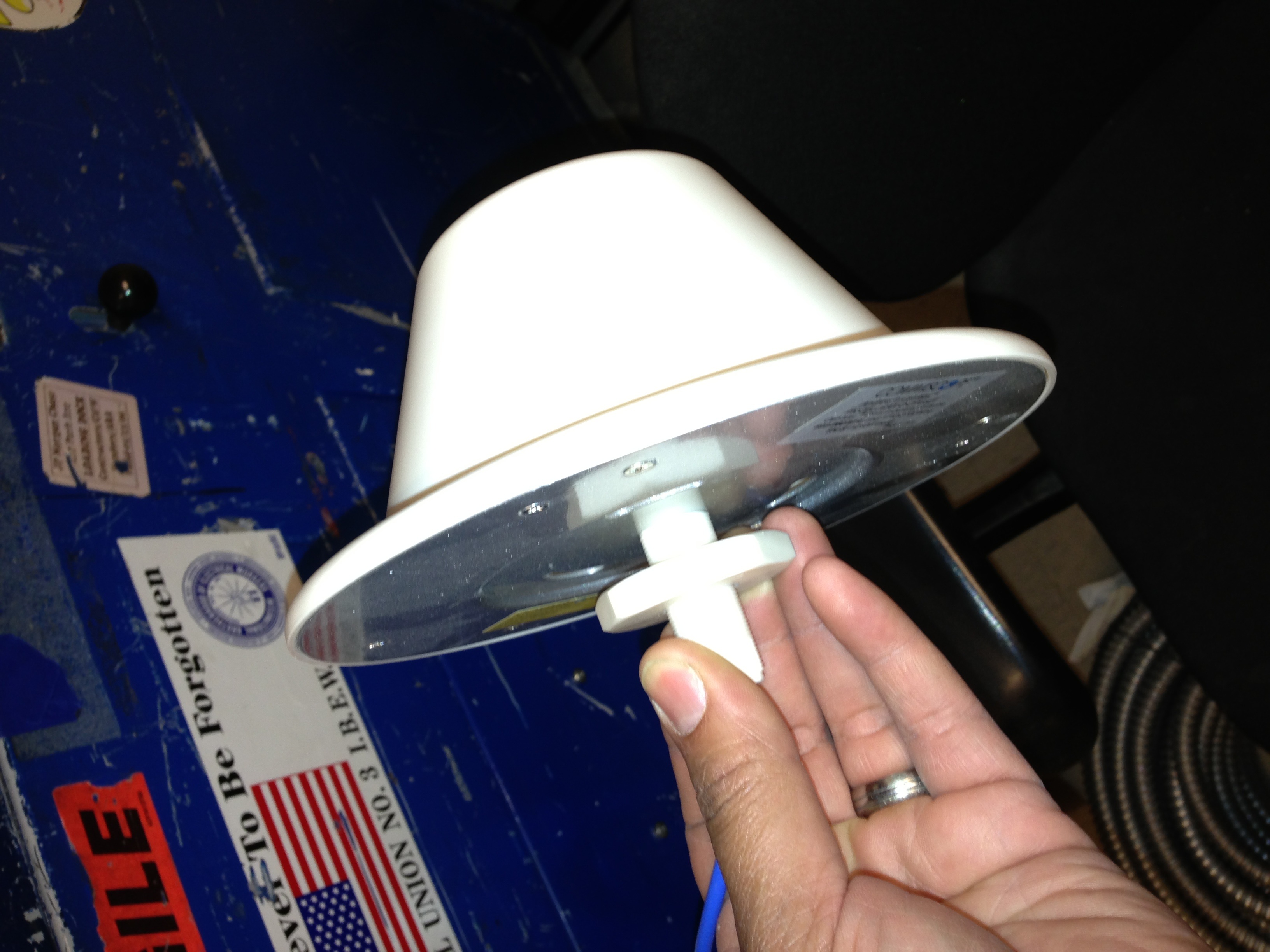

Many schools are brick, large cinder block. Brick has high RF absorption. That is not surprising for schools. But different schools are built differently, and are different distances from towers.
Some hospitals use in building signal boosters fir interior cellular coverage.
I have installed in building cell systems in NYC for buildings with poor cell signal.
