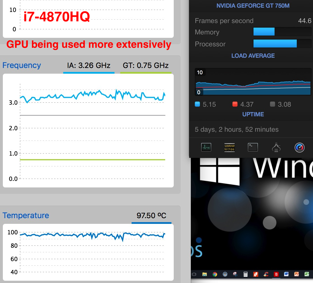

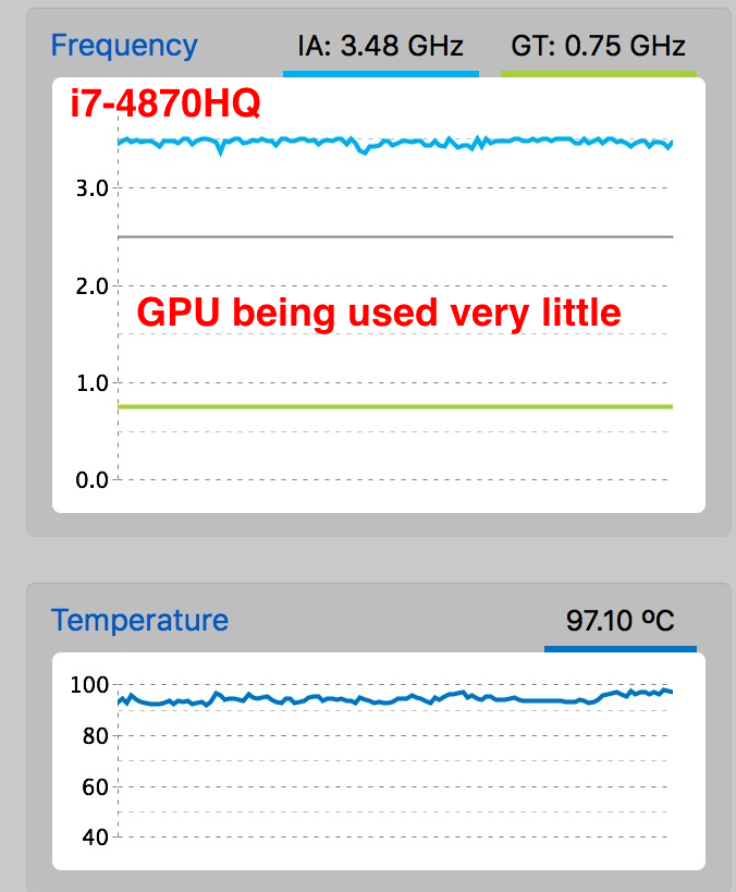

Very interesting! Can my 2014 with the same CPU maintain 3.3-3.5 GHz under multi-core loads because my GPU makes less heat than the 2015's R9? (and hence contributes to less total heat for the entire system to dissipate.) Or is this because of that particular benchmark?

Frankly, I wouldn't even know how to start tackling this... I suggest we should just sweep this under the rug and test the system as a whole 🙂
This was the idea, yes. But again, the entire setup was designed to closely match the kind work that I am doing. Other workflows will react very differently. For instance, I do not have any intuition about burst workflows. Skylake, with its more ALUs and more responsive turbo boost should have an upper edge here, but it would be interesting to look at it at detail. How does one test this though? I have no idea, I am certainly not an expert in this area.
I would certainly expect the 2016 model to perform better here, because of a much more efficient GPU. But again, this is a very complex domain. How many applications are there that will truly push the boundaries of the CPU and the GPU at the same time? The software that is most likely to do that are probably still games, because they usually consists of fairly well defined, semi-autonomous modules that engage at the same time (e.g. AI, resource loading, rendering, model logic). You can for instance send off your rendering commands to the GPU and deal with update logic and AI on the CPU while the GPU is busy drawing. In contrast, if I understand correctly, for professional applications, managing the available resources efficiently can be a major pain. The logistic effort involved in transferring the data here and forth and changing states is enormous. This could be one reason why for instance Photoshop and friends scale so badly with GPU performance...
Of course, it shouldn't be too difficult to write up a small torture app that loads the GPU with some angry kernels to crunch while also trying to fully load all the ALUs of the CPU with AVX-2 instructions. I am sure that this will easily overheat the laptop. But what purpose would such a test serve except testing the limits of the machine? Its certainly neither a realistic nor a useful usage scenario.
What is your take on this?
I was performing the same base activity, which doesn't put much tax on the GPU, but with the sample showing the more extensive GPU usage I was also playing a video in addition to the base activity. Am I correct to assume the sample with the GPU usage shows where thermal throttling is occurring? (both are multi-core loads; IIRC the graph covers something like 2 minutes of elapsed time)
Normally that benchmark doesn't use the dedicated gpu (cpu rendering test) allthough the macbook pro tested has one. You can easily run the cinebench r15 yourself a few consecutive runs however, if you want to check this. It would be interesting to see your results and temps.
My 2,9 has the lowest 450 gpu (which i chose delibeately to avoid possible heat problems), but I don't think this interferes with the cinebench results, seeing that other people get similar scores (up to 750 for the r15 cpu run)
That would be my assumption as well. Also, note how the temperature always stays in the magical 100 degrees range — thats the max safe operating temperature for the CPU. It it hits that temperature, I'd say its fairly safe to assume that throttling is already happening.
