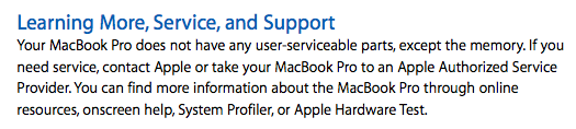

See the attached screenshot from my computer's manual. I can't see how the HD is possibly user serviceable given how difficult it was to get to it and how much damage I could have done in the process. What's your source for that info?
My MBP manual has instructions for the user to swap/upgrade both the HDD and RAM. This isn't a problems and will not void the warranty. The battery, however, is clearly marked not to be replaced by the user and doing so will void the warranty.
