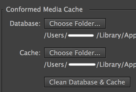

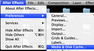

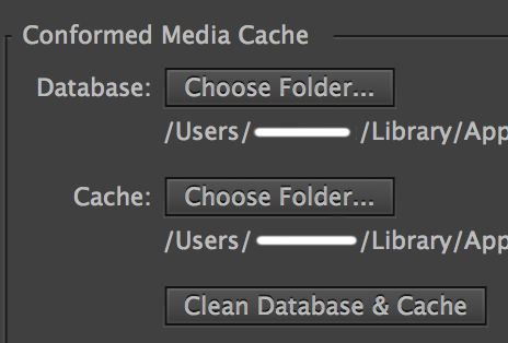

Cleaning AE Database and Cache
I have a 2012 MBP an 2011 iMAC that I use at work extensively for AE, Premiere, and FCP rendering...
What I found out today while dealing with the neverending "preparing to copy files", was that once I've cleared the cache from within AE, my file transfers became instanteous (almost).
I'm not sure if the original post (gslrider) uses AE, but this sure fixed my problems... low level memory was occupied by some software, making file transfers literally impossible. If you've setup scratch disk from within FCP, I'd go through that scratch folder and clean out any old projects as well.
(In AE, go to Preferences>Media & Disk Cache...>, and click on "Clean Database and Cache) Empty Disk Cache where you're at it.
Hope this helps you guys out.
