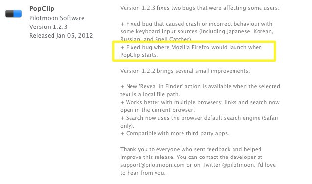

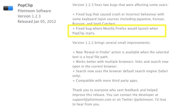

PopClip is the culprit!
I had looked everywhere on my MacBook, and did not find anything. Finally, in exasperation, I ended up removing Firefox. Well, while updating PopClip (a WONDERFUL and handy little utility), I noticed that one of the bugfixes involves an issue with launching Firefox (see attached screenshot):
Info can be found here:
http://pilotmoon.com/popclip/
I am so glad to finally find the answer to this perplexing issue! 🙂
