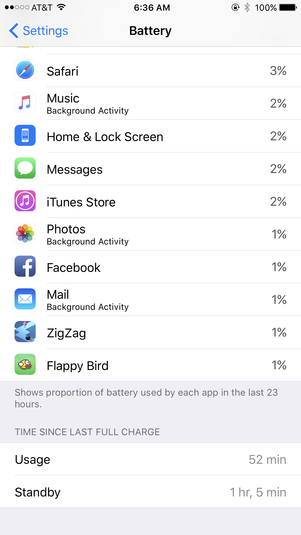

Seems like I can get 45-50 minutes of use before it switches to 99%, but the rest of the battery depletes faster.

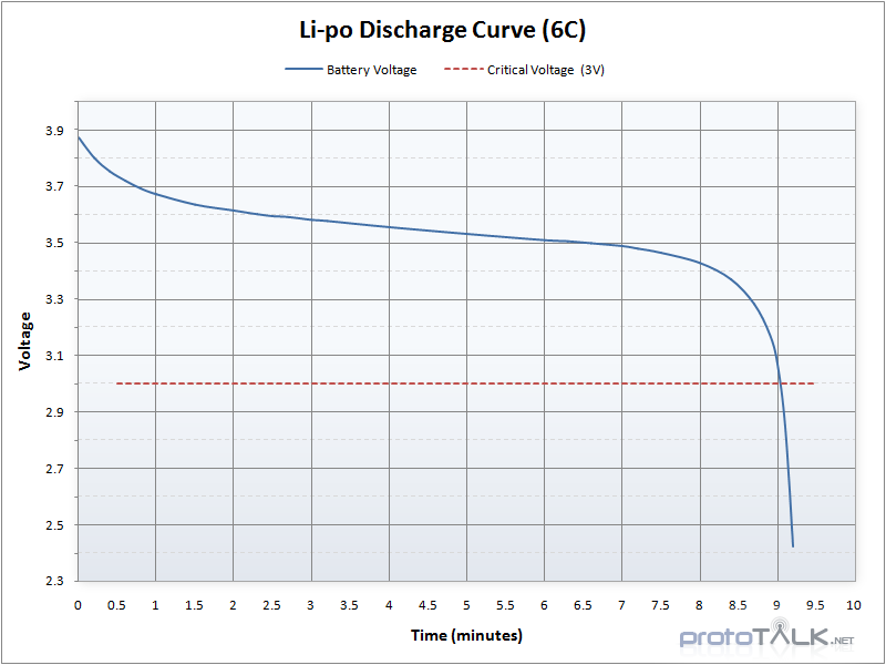

Let's say you have a x/y graph of a straight line. If someone gives you a Y value, it is easy to find the X value.
Now look at the line of a graph of voltage/time graph of any battery, it doesn't have a straight line near the 0℅ and 100℅ points of the graph.
With the example graph I gave, if the phone reads the battery as between 3.9 and 3.7V, it might think zero time has past and estimates it has 100℅ still.
This is same reason on the other side of the graph, if the phone reads between 3.5V or lower, it is harder to estimate the lime left.
Example graph of a battery.
5112a224ce395fb479000003-png.676067
