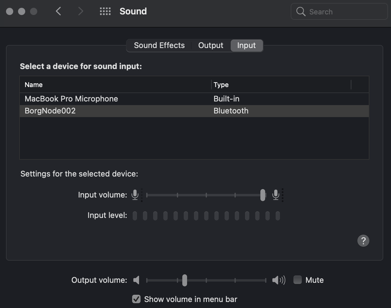

Set your microphone in the sound settings to the internal mic. Does wonders for AirPods battery life especially during long Teams/Zoom video calls.
Click on MacBook (Your Device) Microphone (I am in a meeting using my AirPods right now - but it's a short meeting so I don't mind). But longer meetings I do MacBook Microphone and it makes the AirPods last a lot longer.
