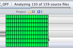

Oh yea, you can saturate the i7! See attachment. What I'm doing there is having Xcode analyze a large project. 😀
Sure, you want the processors doing all of the work that they can. It's a balancing game. If your drives are too slow to deliver the items to be rendered or slow on writing that render back, then that would be a bottle neck to fix, if possible. If you are short on memory then potentially you'll be using the drives as a virtual memory system which wastes a great deal of time. As pointed out by someone else, you analyze your system via tools like Activity Monitor.
When you have 16.8MB of free memory, then closing Safari which is using 13.67GB of your 16GB can help the system out greatly. Yep, that has happened to me.
