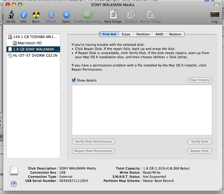

Is that one a drag and drop walkman? Or does it need SonicStage? Also, when you insert it into the USB port, does the disk mount? Can you send a screen shot of your disk utility with it inserted?
It's a drag and drop, no special SoftWare needed. In the old MacBook the walkman appears like any USB drive, to which I can drag and drop music. On the new mac however, nothing at all happens when I insert the walkman; the mac doesn't react.

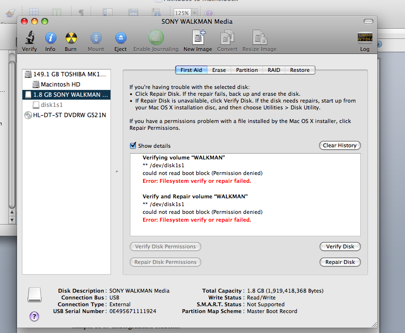

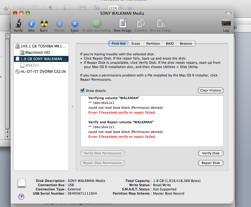

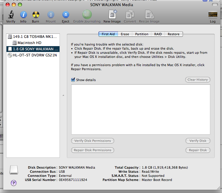

It did find something after all. But, it still doesn't look very promising.

Well from your picture disk1s1 (the main partition) is not mounted... click the greyed out disk1s1 and then click the mount icon at the top... what happens then?

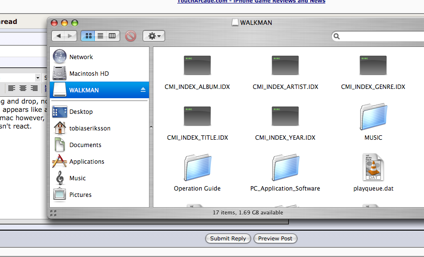

Ok, I did that, and what happened is this (the main partition is gone). However, the information box said "fail, permission denied":
Is it possibly mocking me? Damn Walkman...

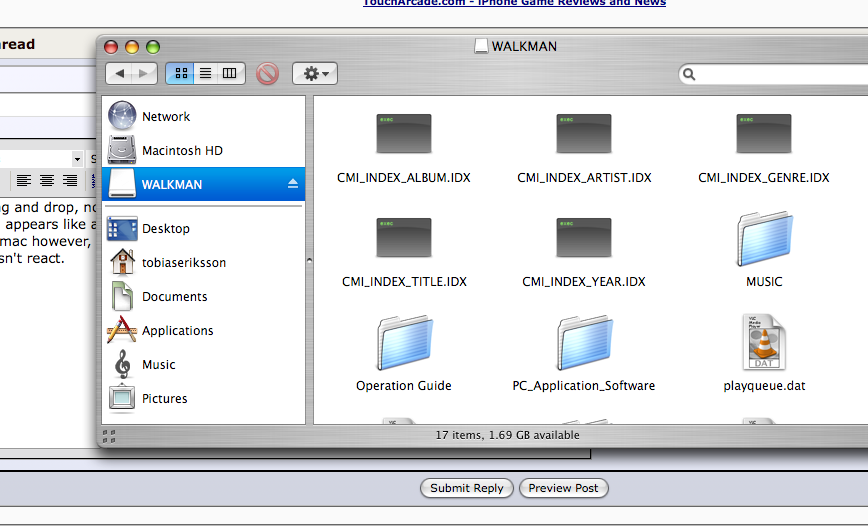

I did it on the old mac, and - lo and behold - the new thing actually appeared for the first time, mounted, on my new computer. However, I added a folder named "MUSIC" with a song in it, tested that I could play it (I could) - and then the disc did not appear in finder again once reconnected with my new computer. This is very similar to what happened the first time it appeared. Also, I tried to partition again, and it just does not work! It seems to work once and never again...

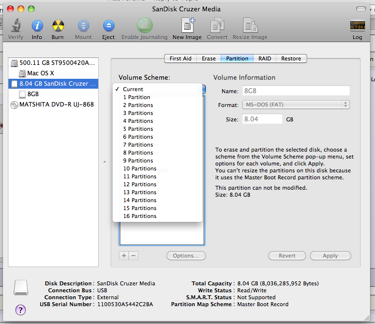

Regarding the actual partitioning, I have chosen MS-DOS file system (FAT16) format, is that alright?
Any more ideas? I am very impressed with your lack of despair 😛
Very strange. But when there is a problem, there is a fix 😀. I format flash drives as MS-DOS (FAT 32), as it is slightly better (and faster) than FAT 16. Hmm, so if you format it on your old computer, your new one mounts it? Once mounted, can you then format it with your new one?
Also, under options, make sure it is set to 'Master Boot Record', as i predict the mp3 player will need this.
