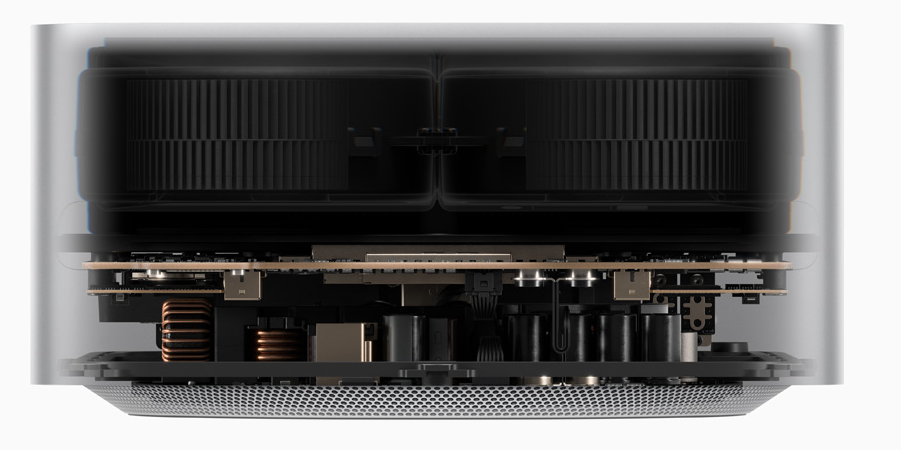

In the below image from Apple's site you can see how huge are the PSU components at the bottom of the computer. They will generate a lot of heat.

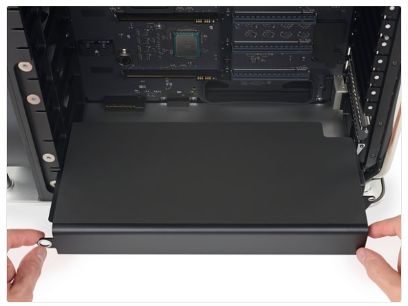

For comparision purposes, the actual Macpro uses a 1200W PSU. As stated before, MacStudio will use a 370W one. Below image shows iFixit's teardown of Mac Pro. The black thing being pulled off is the 1200w PSU.
