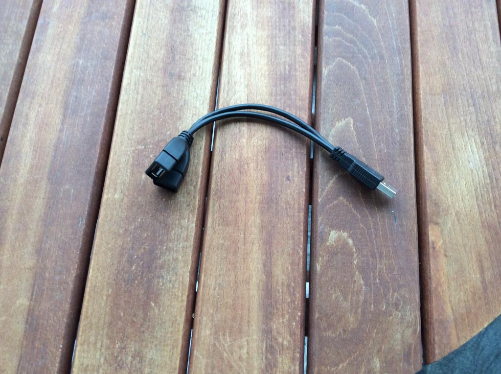

Its a simple USB splitter. What I wanted to do is add my Logitech MX mouse and Logitech keyboard USBs to it. When I connect one of the two USBs to the port on the back of the iMac, it works fine, but nothing works when both are connected. I tried one of the two, with my HD webcam as well, and again, nothing works. I tried a different port, but again, nothing works. Is the power from the USB just not powerful enough?

Because USB devices send data up and down the cable. If you want more than one device in a USB port, you need a hub to control which data flows to and from each device. You can't just solder two data wires into the same connector like that.
I have no idea why that cable even exists. I've seen cables that feed two USB ports into one device (e.g. power for external hard drives), but never one that splits the other way.
Don't believe there is any such thing as a simple usb splitter like an audio cable splitter. The 'splitter' must have a USB controller chip in it. There may be some incompatibility or it may be defective.

That cable is for power only like splitting a sub charger or one device and power to another.
