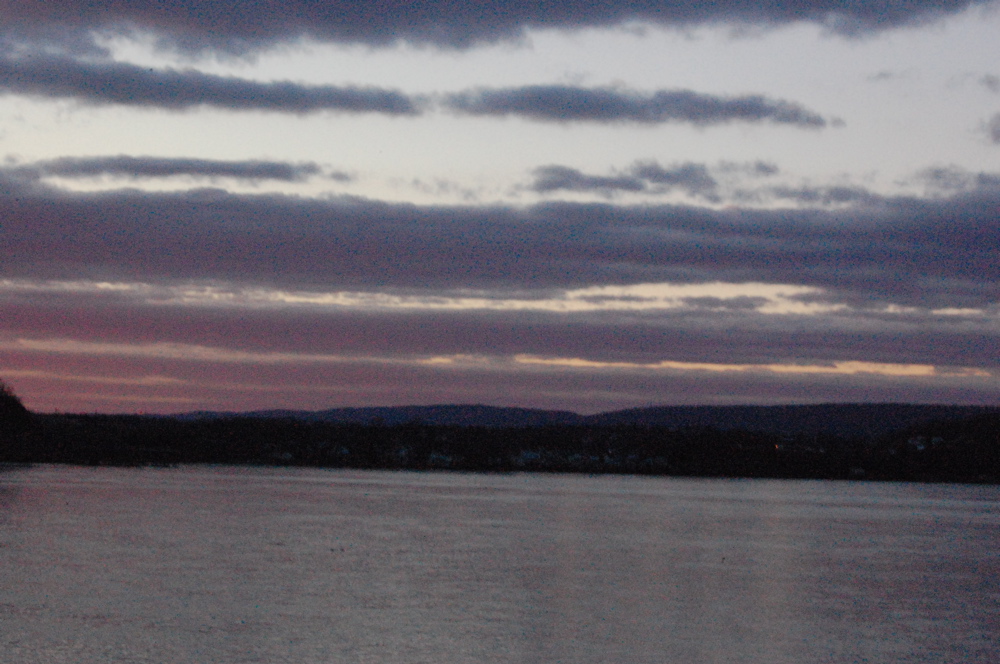

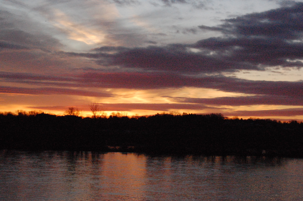

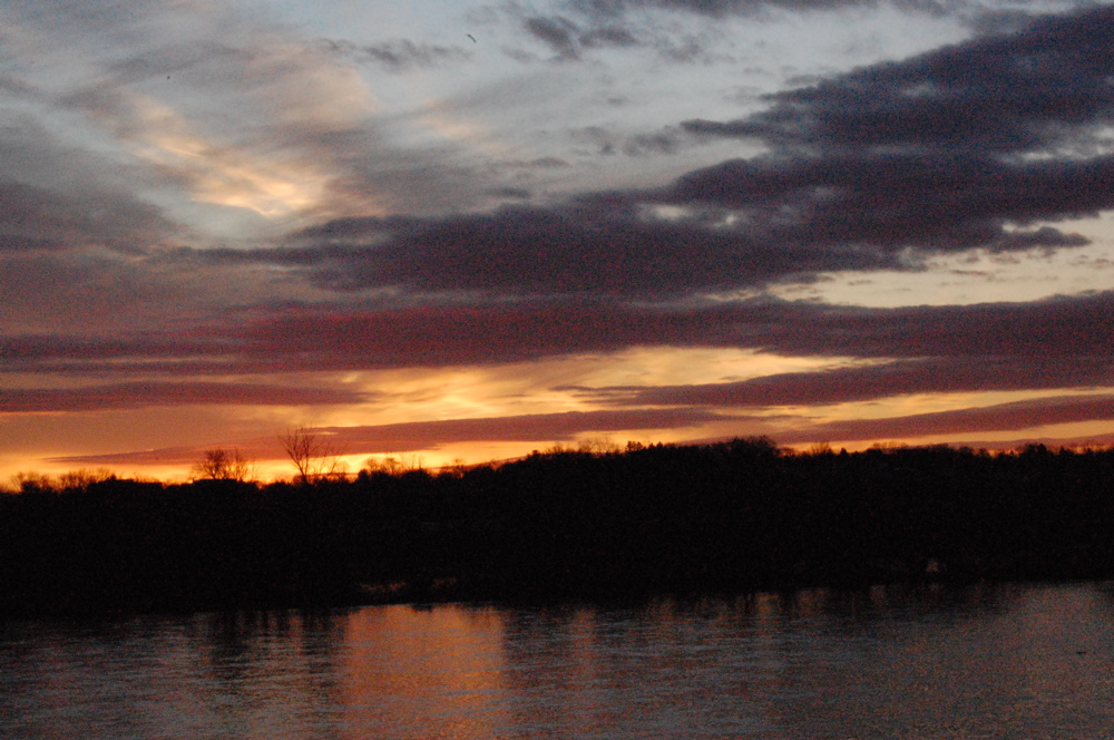

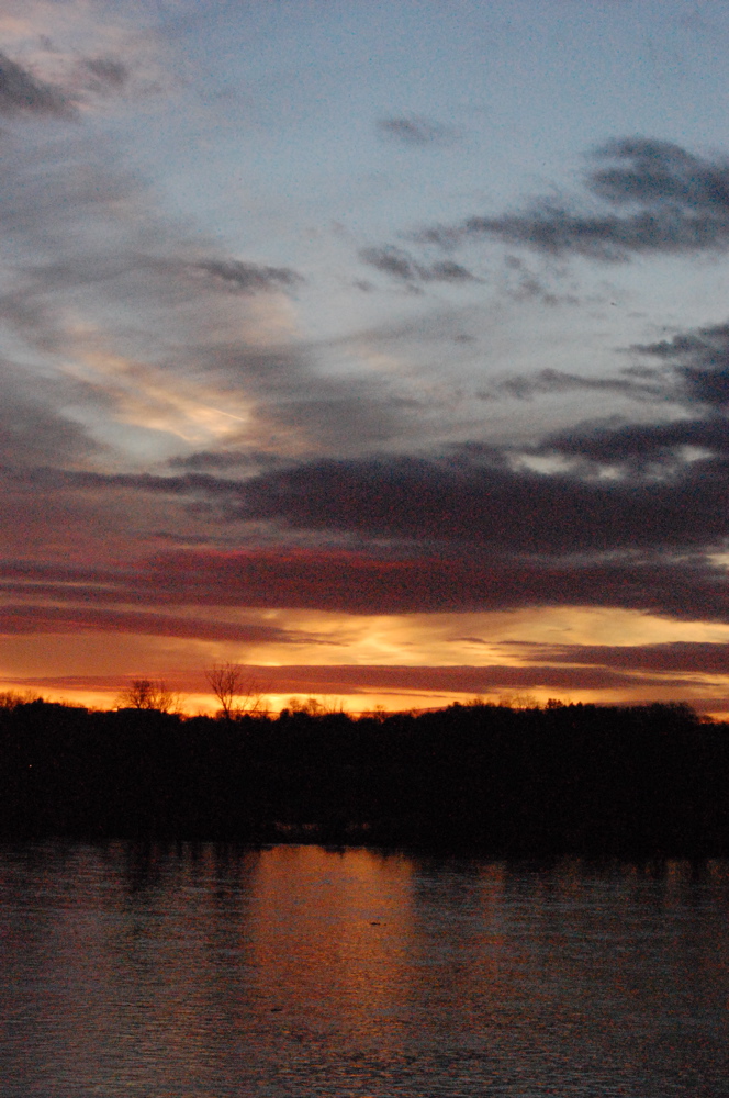

Why did these pictures come out all grainy? I took them with my new nikon d40. I switch lenses for the first time to my 55-200 mm lens. It doesnt look like dust to me though. It seems like it must be something to do with the light?
thanks for all of your help.

A couple things:
I looked at the first picture in Photoshop - you shot it at f/32? You're looking at serious diffraction issues at that small an aperture. You probably should never go below about f/13 if you're worried about sharpness.
Did you use "save for web"? The ISO value is not stored on the photo. If I had to guess, you've got your camera in "auto-ISO" mode and it shot the photo at a higher ISO setting. This sort of photo should really be shot at low ISO and using a tripod. Low light + hand-held = blurry pictures (or very grainy/noisy pictures).
I had my iso at HI 1. It was dark out and i thought that the higher the iso the brighter the image would be. Please tell me if that is wrong. The camera says that HI1 is about 3200 iso.
what is f/? How do i change it? unless save for web is an auto setting i havent changed it on purpose. I dont have a tripod. Should i turn on "noise reduction"?
OH YEAH... Definitely ISO. Your right but the problem is at an ISO of 3200 your image is going to be super grainy. The problem is that the grain is noise produced by your sensor chip.
You're making the image brighter but you're sacrificing with more grain. The best thing to do is back off of F 32. On a digital camera around F 11 - F 22 is fine for sharpness. Another rule of thumb (for me as a "professional" in photography anyways) is to never go about ISO 400ish. Above that and noise becomes a problem.
So your best bet would have been (and guessing on scene, etc.) F 11 @ 1/2 sec to 2 seconds. That's with a tripod, lol. Without... Hmm... Have any VR lenses?? 😀
The only other option would have been (and what some call HDR). I prefer to do it on my own verses Photoshop or Photomatrix and that is to take an exposure for the sky, an exposure for the trees, etc. and a final one for the water and blend those in together in photoshop manually so I could get the exposure right for the sky, enough for the trees to see detail in the shadows, and a nice, glass-like look in the water.
~Crawn
I am going to echo what has been said above!
High ISO does allow you to compensate for low light, but the higher ISO you use, the more grain or noise you introduce into the photograph. It is a trade off (sacrificing quality for the ability to shoot the photo).
When shooting scenes like this, here's some tips to get you started:
1) Use a tripod. Can't stress that enough. The shutter speed for a correct exposure is going to be too long for hand holding (even with VR you won't be able to decently handhold below 1/15 or so usually).
2) Set your camera to Aperture Priority (A) mode.
3) Set your ISO to 100 for the cleanest image. You don't need to worry about the amount of light because you aren't hand holding.
4) Now that the camera is up on a tripod, you're in A mode, and your ISO is 100, set your aperture to a decent one for detail throughout your scene. Somewhere between f/8 and f/22 is fine. The camera will pick an appropriate shutter speed.
5) Use the timer to trip the shutter, rather than you pushing the button down yourself (this shakes the camera).
Enjoy!
The "f number" is the aperture - how wide an opening the blades inside your lens make. The larger the aperture, the more light that is allowed into the camera. The aperture is expressed as a fraction of the focal length; so larger numbers (f/13, f/16, f/22) actually mean progressively smaller openings.
You might want to read the Cambridge in Colour tutorial, although it can be rather technical. Scroll down to the section titled "INFLUENCE OF LENS APERTURE OR F-NUMBER".
Your camera's manual will tell you how to change the aperture.
Thanks for the help. I turned my iso down to 400. I turned on noise reduction and i should be getting a tripod at some point for christmas. Thanks for all the help. The first thought i had was that my camera had gone crazy but now i just found out it was my own not knowing what do with settings. Thanks for all the help again. I hope you can help me again another time. Thanks so much.
