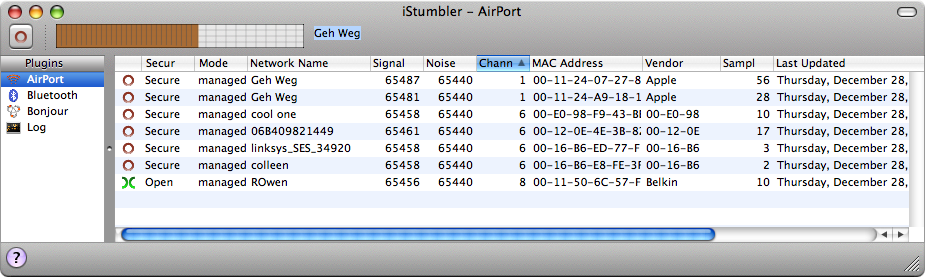

Most routers default channel is 6, so it's not unusual to see neighbors clobbering each others WiFi. At my place, my MBP picks up 4 neighbors all using channel 6. My MB picked up even more. 😱
The other thing is that channels near each other (i.e. channel 5 is near channel 6) somewhat overlap each other, so if channel 5 doesn't change things quite as good as they used to be, try channel 1 or channel 11.
There's an excellent tool called iStumbler that you can download that will show you what channels the networks around you are using.
Do I need this tool if I'm the only network that my Airport picks up? Occasionally I will get one more but it never connects.
Nope, it's just a tool that I think is fun to use, but if you don't have more than 1 or 2 networks around, it'd be kinda boring. heh
