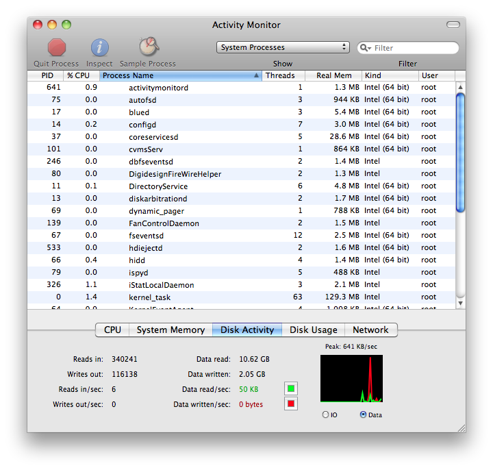

Reinstall Mac OS X with the Archive and Install option. I don't know how you have deleted the root user, but that root user is not to be deleted as the system needs it.
Look on the right side of the following screenshot, and follow the User column.
