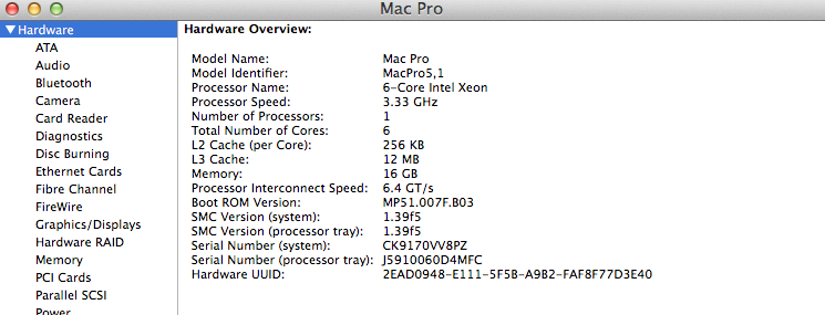

Hi,
i cannot upgrade my Mac Pro 2009 with the firmware 5,1
When i reboot the Mac the firmware not changed...
Why?
I have:
- Asus GTX770 DirectCU II OC 2Gb
- Inatec KT4004 PCI-Express card USB 3.0
- SSD OCZ Vertex 3
I have cloned my SSD in a HD and is the same.
Thank's from Italy

May be because you should shut down the machine and then start it from cold boot (from memory, you have to press and hold the power button), but not "restart".
I should shut down the machine and then start it put the button start until the LED starts blinking.
I have my old ATI 5770.
If i put it and upgrade the firmware, after I can put the GTX770?
Thank's
Yes, after the upgrade you can put in the GTX 770 again.
Only for the upgrade you need an EFI card.

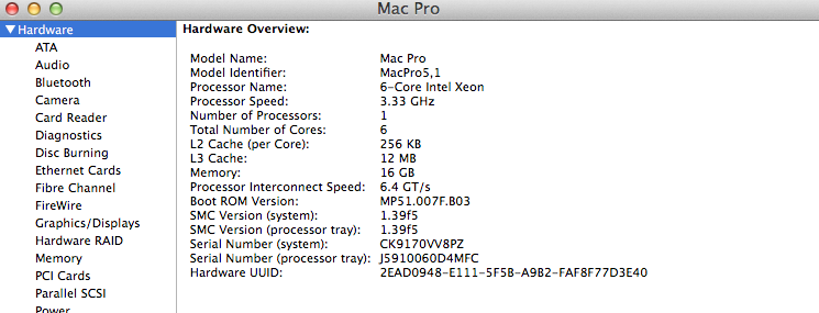

mine shows 5,1 in the equivalent screen shot to the one he posted (mine started out as quad core 2009)

What does About this Mac window look like on yours?
The "About This Mac" will tell you it's a 2009 machine (but nothing said it's a 4,1 or 5,1).
However, the info in "System Information" will tell you it's a 5,1 (but nothing about 2009 or 2010, etc).'
You previous post said OSX will indicate itself as a "4,1", which may confuse the others assuming that you were talking about the into in the System Information.
About this Mac overview lists it as Mac Pro Early 2009 Granted thats a 4,1 but its not the screen he posted/was referring to
Thanks you are correct. About this Mac says 2009 even after the upgrade. The identifier is updated to 5,1.

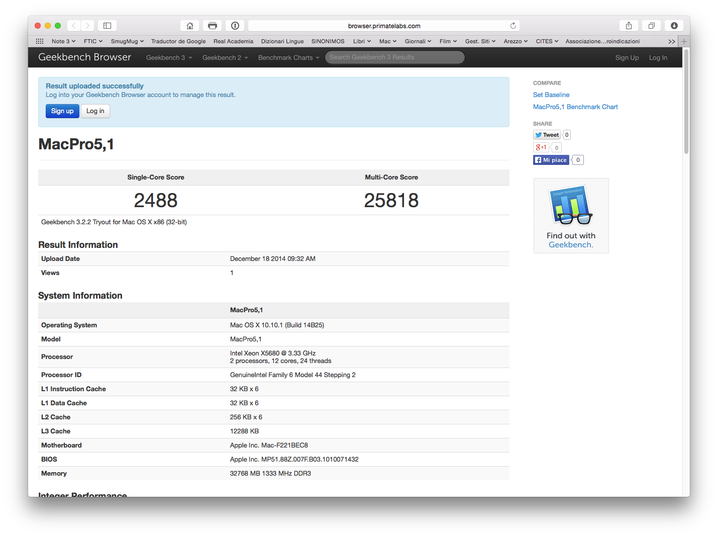

Hi,
i upgrade with 2 x 5680 but ram speed is at 1066 Mhz.
Why?????
thank's

Hi,
Why?????
thank's
If those RAM support 1333 CL9, you may try 2 things.
1) Reset PRAM (think twice before you do that if you have 3rd party SSD with TRIM enabled).
2) Only install 6 sticks (in the optimum configuration) to check if they can run at 1333 (PRAM reset may be required).
Ssd + gtx770
Hi,
thank's for reply me.
2 questions:
1) i have a SSD OCZ with Chameleon trim enabled. It's ok?
2) I need utilizade the Ati 5770 original?
1) Disable TRIM before you attemp any PRAM reset on Yosemite. You can re-enable that afterward.
2) AFAIK, graphic card is independent to this problem. No need to touch that.
If you have a bit worry about that. You may try the 6 sticks option without PRAM first. That's virtually no risk. However, for Yosemite, I still highly recommend you disable TRIM before any testing, just more safe.
For Mavericks, you are bulletproof, no need to disable TRIM. However, it seems you are with Yosemite now. So, be careful.
I's work
Thank's, Now it's work fine
