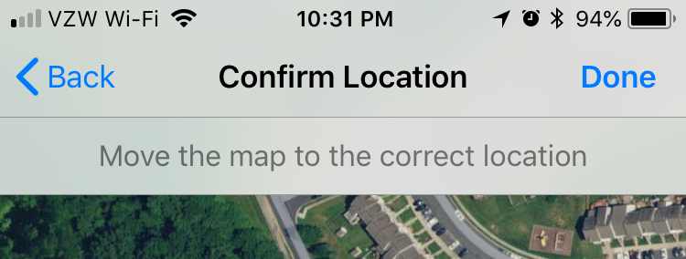

For example the location base automations. Its not impossible to directly set your addresses real location used for geofencing. You just goto maps and type home, or search contacts for yourself and tap your home address. Tap your home icon on the map, press edit location, verify the address is right, then press Next. On that screen you can precisely move and pinpoint your house on a satellite image of the area. This way if you are a few houses off you can fix it.
It will look like this (I cut the satellite view off for privacy).

As far as I’ve been able to tell, HomeKit does not use your street address or Apple Maps’ home/contact location to determine your “Home” location pin in Home app. Because I’ve gone into the Maps app as you suggested, and my home pin is located correctly. And just to test the idea, I moved the pin a bit closer to the center of my house to see if that would fix it in home app, but it had no effect.

For example if you re setup the automation and type your address in (instead of “Home”) you will get a geofence parameter that you can adjust that might help your situation. It’s a nice feature to use for thermostats so they come on a bit sooner (larger parameter). However your issue could be several number of issues.
