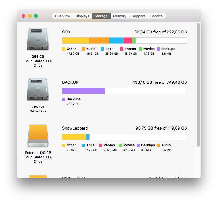

What I will add is that when I go into Apple-About This Mac-Storage it says that I have used 12GB of Audio when my music folder is only using 2GB. And that I have 8GB of Photos when my pictures folder only is using 3GB.
You can't rely on that. It never works correctly. Reindexing Spotlight could fix it for a short while but even if it works it gets messed up again. Same for Disk Utility.

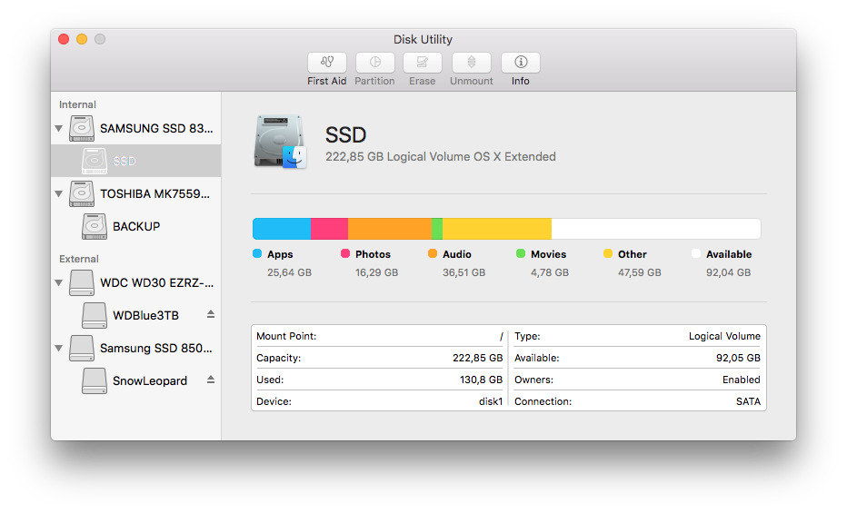

That Window isn't resizable too like Disk Utility. 😡
[doublepost=1463567573][/doublepost]There are two ways to rebuild the Spotlight index:

Like Erdbeertorte mentioned, you can pretty much ignore that storage readout as it seems to be perennially screwed up.
