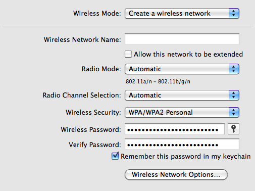

Have you any special setup settings?

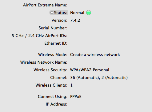

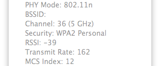

My settings:
