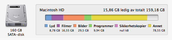

I just deleted tons of stuff to try to free up hard drive space.
I removed huge galleries in iPhoto, all my movie projects in iMovie, half of my torrents and cleaned out my download folder.
I deleted enough to assume my content would only require half my hard drive space. And it turns out, I was right.
So why do I only have 15 gigabyte of free space left? And what is the 70+ "Other" data occupying my hard drive?
I have looked through my folders and I just dont understand what it is.

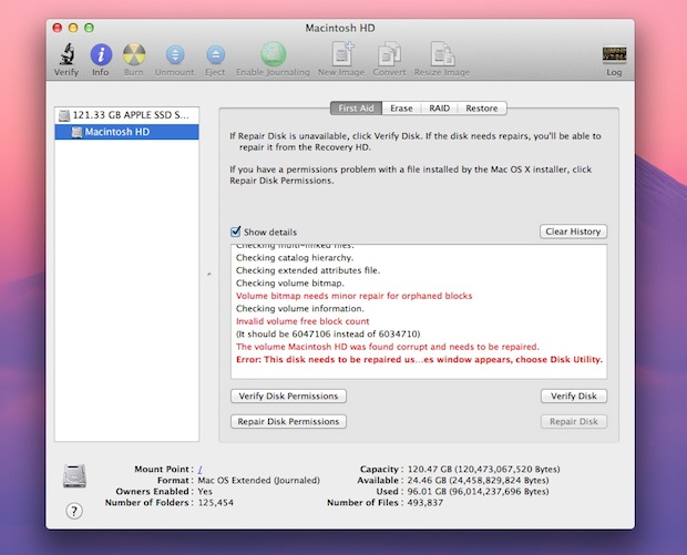

Not the permissions but I am talking about repairing the disk. Once you go to disk utility, you will realize that repair disk is greyed out. In order to repair disk, you should boot into recovery partition but let's first verify disk.
Here is an image I have found on the internet which shows the result if the disk needs repair:
Frankly speaking, I am not too knowledgeable why OS X might lose track of files. The most common reasons are not ejecting disks properly (in case of internal disk, force shut down of computer) and bad updates. For example, while I was upgrading to the Mavericks, my computer lost track of installation file of Mavericks which was around 5 GB. After repairing the disk, it has found it.
But I dont have a bootup disk of Mavericks. Can you repair disk without any disk?
I ran Verify disk, and it told me I needed to repair it, but i forgot what it said. It told me to hold down some keys while booting up
To repair your Macintosh HD drive, you need to boot up from the Recovery partition.
That is what Disk Utility told you : "restart your computer, press and hold down Cmd + r while booting up".
In the "Mac OS X Utilities" window that shows up, select Disk Utility, then select "Macintosh HD", and click on "Repair Disk".
When the job is completed, quit Disk Utility, and restart the Mac.

You will need to boot into the Recovery Partition, run Disk Utility, and have it "repair" the disk. (You can't do this when booted off the disk.)
Some questions:
o What backup strategy do you use? Time Machine or a third-party utility or service?
o Do you have FileVault enabled?
Please let me know, as I'm trying to stitch together a cause for this occasional happenstance. The good news is, it likely does not mean a physical failure of your machine, just something misbehaving. The cure, for now, is to do the steps I outlined above every now and then.
