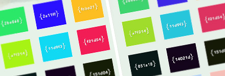

see more info about the color shift

also strangely they use this photo as verification that "save for web" works when clearly the image on the left is more vibrant than the image on the right?
anybody else see it?
