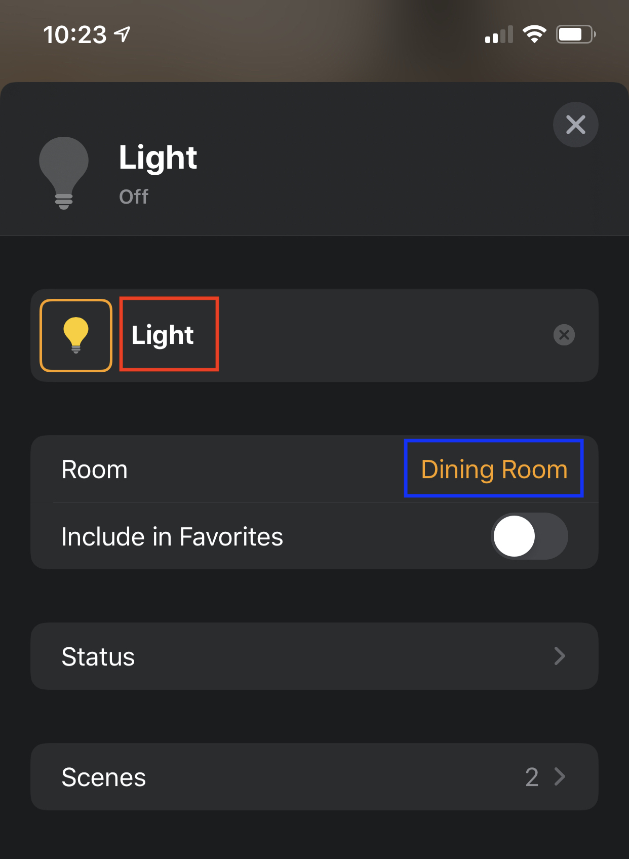

1. Make sure your usage is simple "Hey Siri" Room name Device name Function ex Hey Siri Dining Room Light On as show in your Home app. Words can be added turn on, flip on, grab the, etc but they aren't necessary.

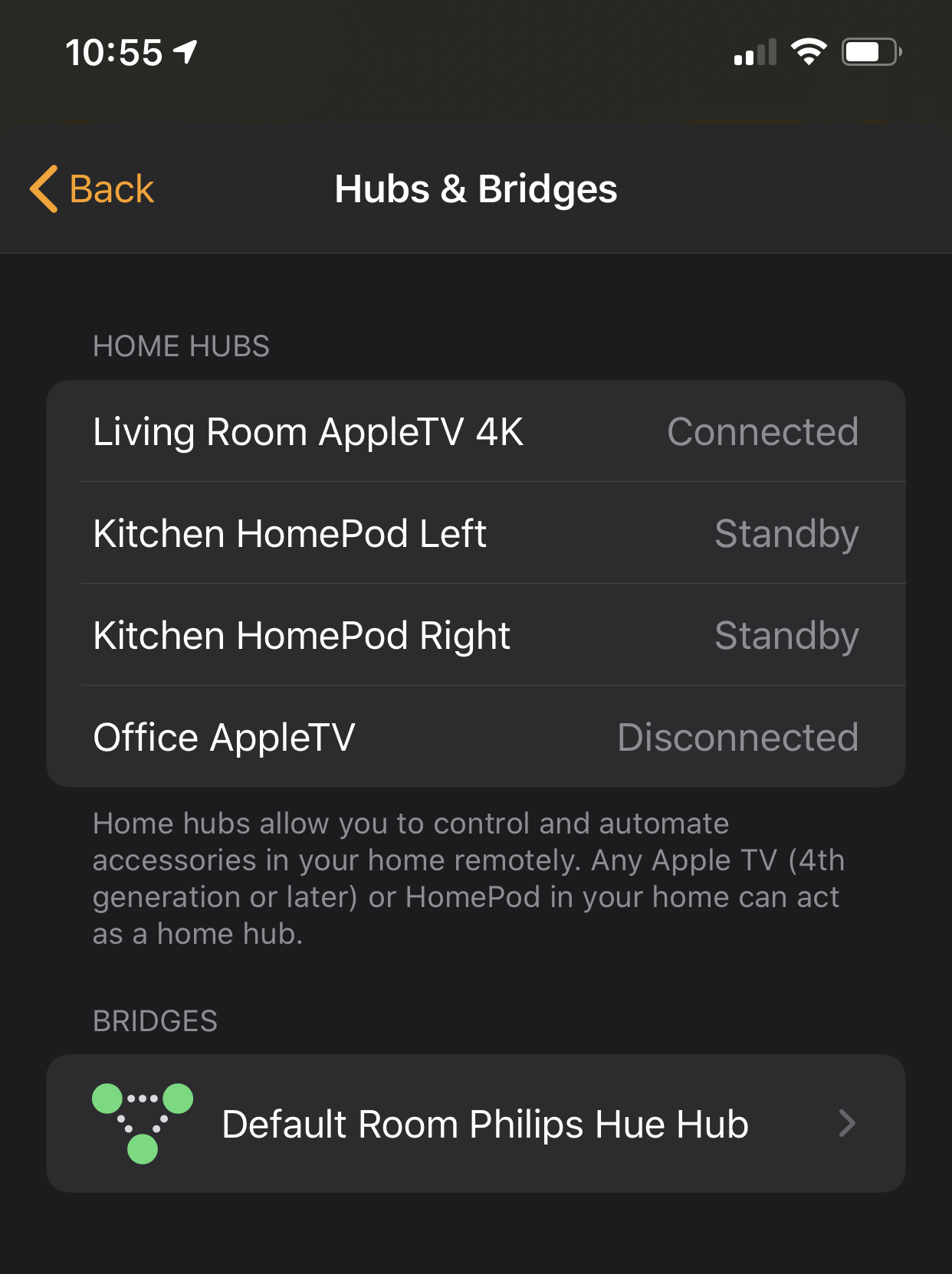

2. On your iPhone goto Home > house icon at upper left > Hubs and Bridges. Which Home Hub says "Connected"? And if its not your HomePod what does the HomePod say next to it?

Under _hap._tcp_ (HomeKit Accessory Protocol Transmission Control Protocol) you should see all your accessories (or single hub for multiple accessories such as Philips Hue). Under _homekit._tcp_ you should see your Home Hubs (including HomePods).

So, after reading your reply I have made a couple of changes that might have caused some verbal command confusion: In the hue app, I had the room name as part of the bulb name too, for example:
Room name: Logan's, Bulb name: Logan's Light and Logan's Window
Room name: Skye's, Bulb name: Skye's Light and Skye's Window
Room name: Tyler's, Bulb name: Tyler's Light and Tyler's Window
So based on your screenshot I have removed the location from the bulbs name in the Hue app, I re-started the Hue hub and both of the HomePods and then started giving out a bunch of lighting commands and have to say that it has improved vastly...not 100% accurate, but I now think I know where most of the problems are coming from....my kids names or bulb names can be misheard or miss interpreted by Siri, as I happened to see what was being heard when my phone picked it up instead of Siri: 1 example is, when I asked: Hey Siri, Skye's window, Green......I saw my phone on the Siri screen as: Hey Siri, Skies window, green.....So Siri is sometimes hearing the word "Skye's" as "Skies"......totally different things which explains some of the stupid or incorrect results.
