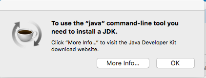

I am constantly being hassled via a pop-up window about using a Java command line tool (see screen shot). I don't know what this even means. After running the search via their site to confirm I have the latest version, I still get this pop-up window. And I've tried this on Google Chrome, Firefox and Safari. This only happens on my laptop, not my iBook. I would really like to get rid of this annoying message.

Malware detection for OS X, instal run, if you don't want to keep just junk it. Want more protection try Bitdefender (free ) from Apple`s Mac App Store, or for active protection try Avast for Mac.
Recommend starting with Malwarebytes, as said something is pushing the pop up, it may well be benign, equally malware on OS X is on the rise.
Here https://www.malwarebytes.org/antimalware/mac/

[doublepost=1455182652][/doublepost]Are you playing MineCraft per chance? My daughters 15" MBP had a similar issue, requiring an update/install of Java, equally all was in order.

Maybe that is the crux of the matter, as you shouldn't need any update for Java for OS X to work, unless a third party application calls for it...
First I would uninstall the Java update, you can always reinstall OS X from recovery, it won't hurt your settings and application, it will however clean out the OS or boot into safe mode. Try Malwarebyes first the OS asking for an update of Java is not normal. Will also help if you set your Mac`s spec and OS version, as other then may chime with similar experience.

I had this popup for a long time. Something is asking for Legacy Java, but installing oracle Java will not work. It is looking for an older version that use to be put out by Apple.
It drove me nuts for several OS upgrades, it always asked for the Apple Java install. Each time I would have to go online and find the specific update needed. Here is the one for Lion through El Capitan:
https://support.apple.com/kb/dl1572?locale=en_US
After a few OS upgrades over the years, a few months ago I decided I either needed to reformat the computer, or track down and kill the app that had been asking for this Legacy Java program once and for all.
In my case, It turned out a very old obsolete program called t-mobile bobsled (it use to give free telephone calls) that launched a daemon helper app at every startup up that used the old apple Java. I finally figured it out by going into several system folders until I found the offending program. Here is an article that shows some places to look:
http://www.macworld.com/article/2047747/take-control-of-startup-and-login-items.html
I would recommend trying to find the offending app/ process by checking the library & daemon folders above, as whenever the next major OS revision you will have the same problem again.
