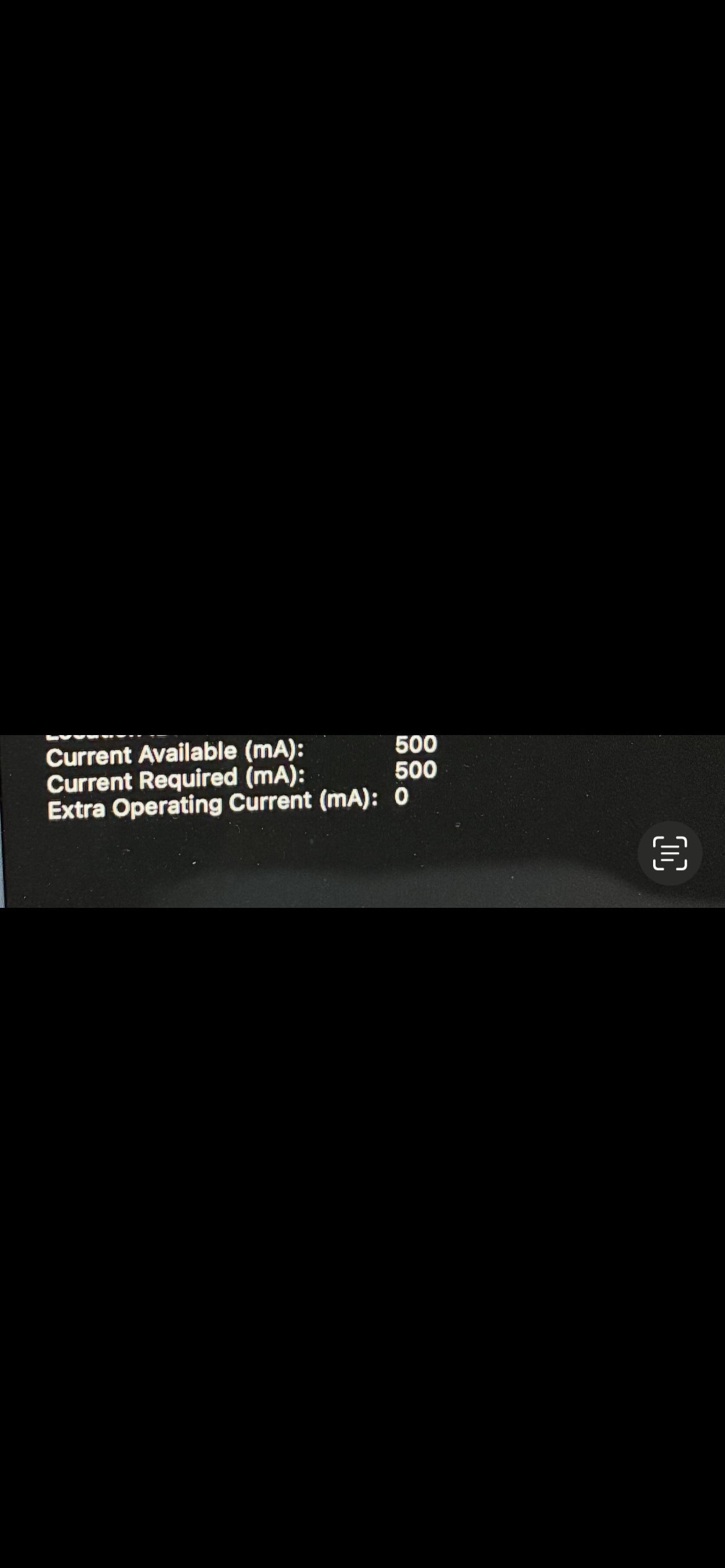

Current Available (mA): 500
Current Required (mA): 500
Extra Operating Current (mA): 0
I connect Beat Pill with Macbook using a UBC-C cable for both power and audio. But the Power from MBA is not enough (only 2.5Watts).
I don't wanna drain Pill's battery. Is it possible to pump up the current to about 2000? Thanks

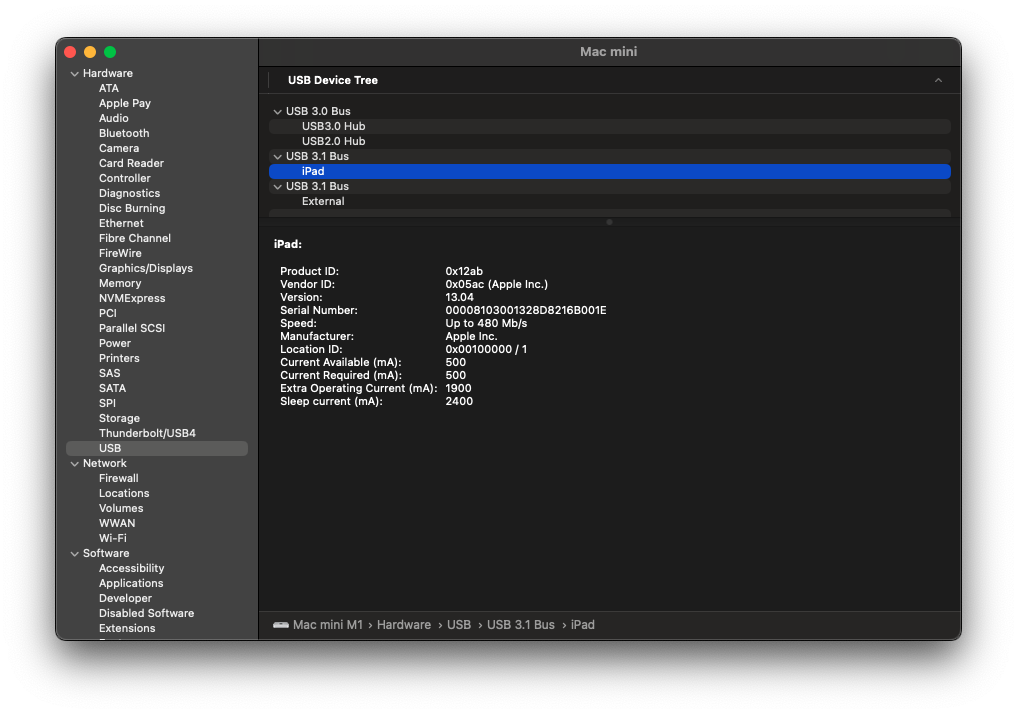

The Pill is on the latest firmware? I do not have one, but the connected device should negotiate the needed extra operating current, e.g.,
can you show the full usb device tree?

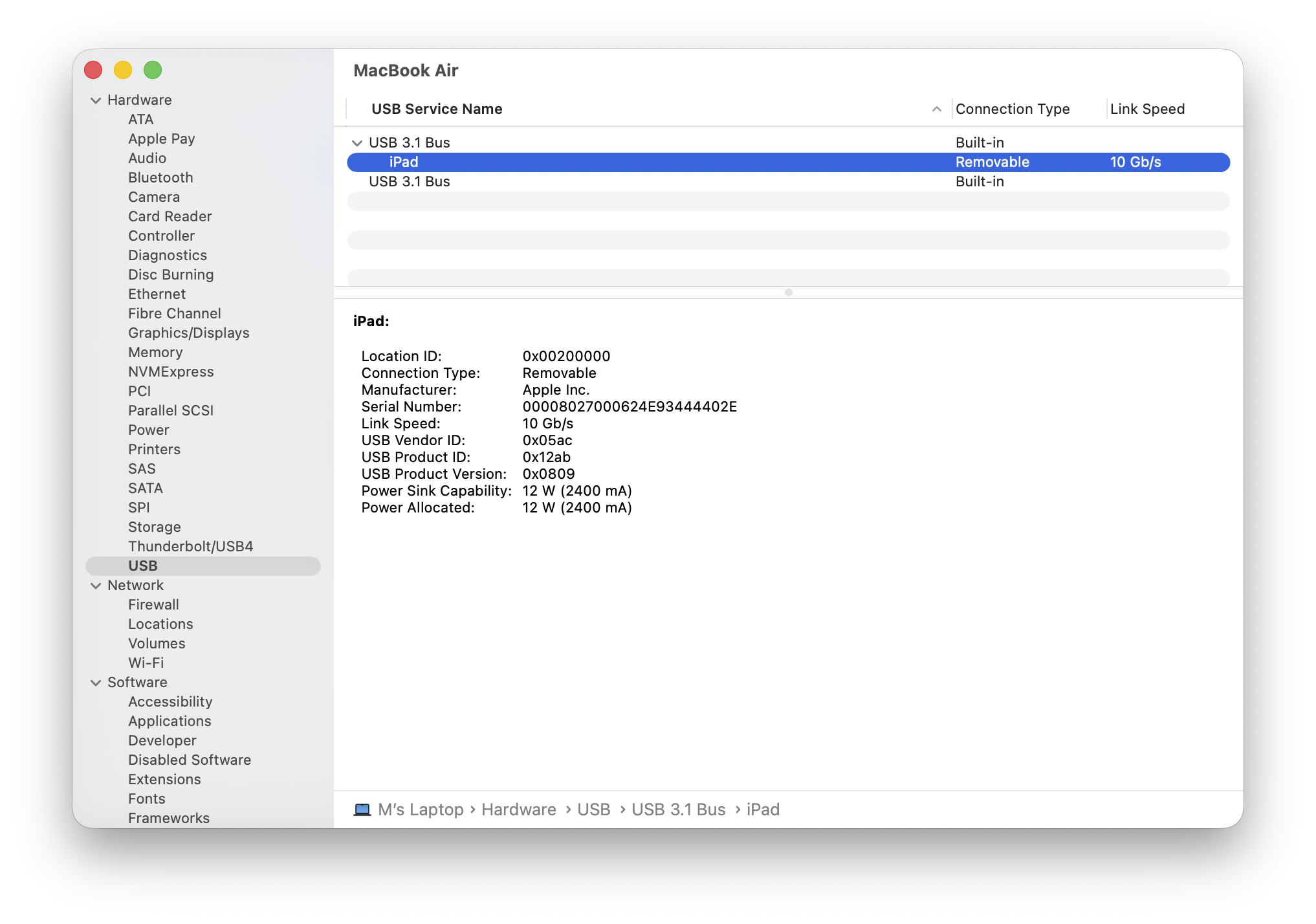

Can you share a screenshot? As said, I do not have a Pill, but everything I connect, iPad, JBL Flip 7, Beosound, reports back as USB 3 with higher current feed from the Macbook Air (as shown above).
What link speed is reported for the Pill?
