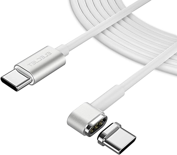

With my wife's devices equipped with a Lightning port, I bought her some "classic" magsafe type cable and connectors. Worked very well. Insert the "plug" in the device, and then use cables with the matching magnetic end.
There are similar cables for usb-c:
I bought a cable w the magnetic plugs. My only issue was that the plug did not magnetize strong to the USB-C end. But maybe I expected too much for the small head. I tried using the magnetic cable in bed, and I was always knocking the cable loose. (No comments, please) Maybe I didn't give it a decent chance.
