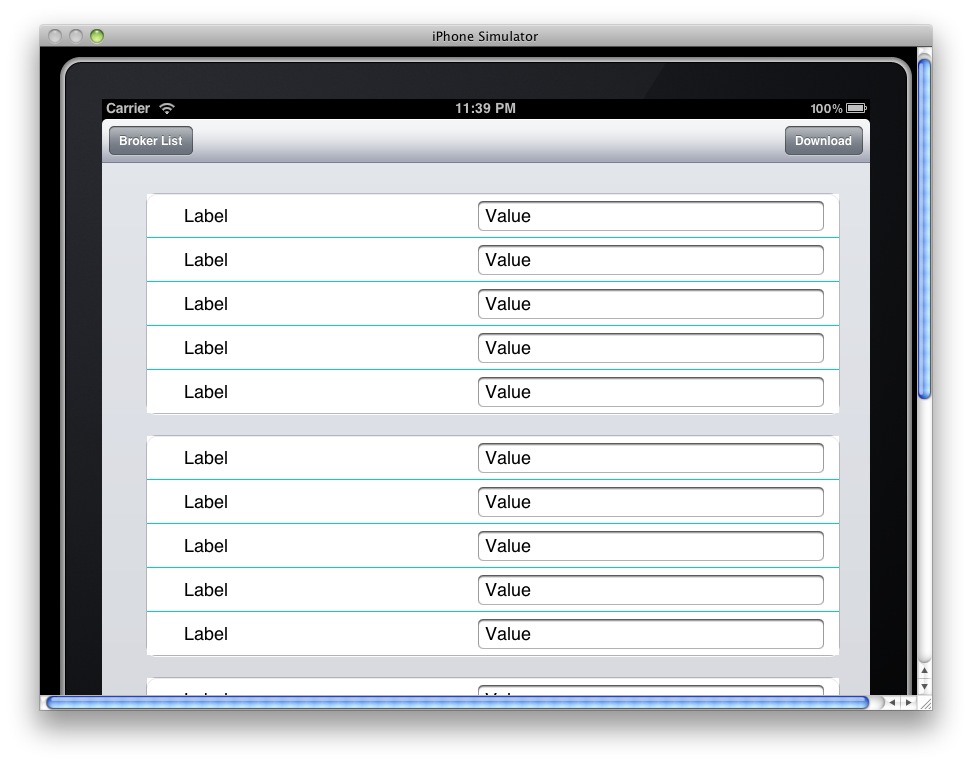

I made a table view in nib file and set style to grouped, then I put a TableViewCell into table view, but when I run it, I found it is no round corner in grouped table view?
How can I show round corner?

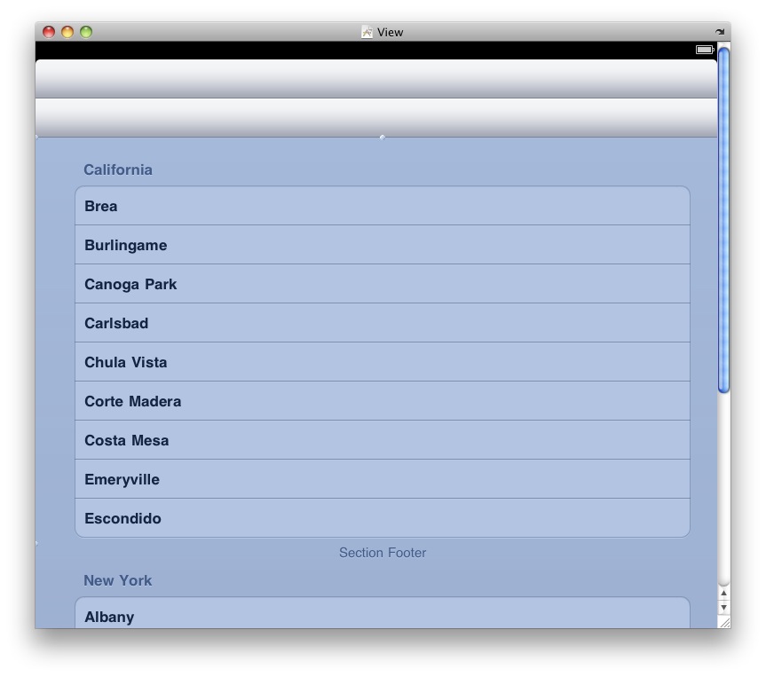

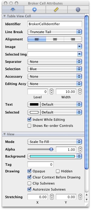

Here is my table view cell attributes.

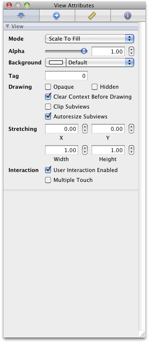

Think about how the layers (subviews) that make up the cell are drawn. Think about how the background colors affect that layering. It may take some creativity and pondering before you come up with the reason.

If you look closely at the tops of your table sections you will actually see that there is rounded corners. But there is something in your settings that is causing the table sections themselves to render different as well as the cells at the bottom of the sections.

Well, I got what I need in programming as below.

  1. Figure out how the background colors of your subviews are affecting the rendering of your cells.
  2. Adjust the layout of your subviews so that they don't overlap the corners.

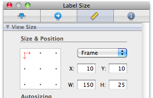

All you're doing is setting the UI elements' frames. This is easily done in IB using the Size Inspector, as seen below:

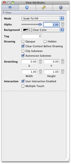

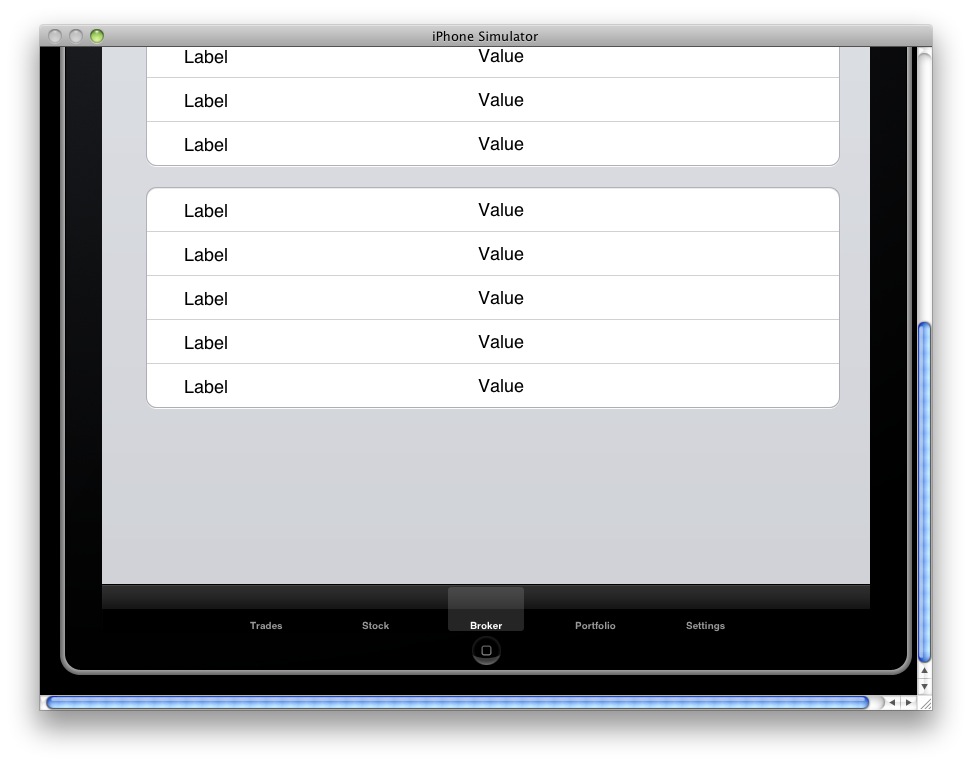

Now I got what I need in IB, like you said that is cell"s contentView background, I set it to clear color.
