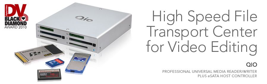

But this (I followed your second link) wouldn't be hot-swappable, would it?
It looks like other PCIe readers I've checked out, and non of them are hot-swappable.
Is this one, by chance?
malch
http://www.sonnettech.com/product/qio.html
http://www.sonnettech.com/news/ibc2010/index.html
malch

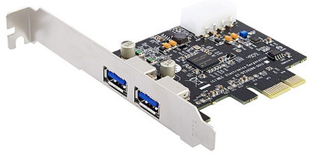

You are not hot-swapping the PCIe module, you are just hot-swapping the Expresscard you insert into the module. It should work.
When talking about hotswap you can't go down the chain of connected modules. I mean if you install, say a PCIe USB controller
...then of course it is not the same kind of hotswap to hotswap the whole controller (like removing it from the mac pro), as it is to just hotswap a USB connection to it.
hope you follow 🙂
Once again, thank you Cindori, for the info. I'm going to have to read and re-read this a few times. From what I've gathered on a site dedicated to the kind of camera I use (which uses SxS cards), no one knows of a PCI-e reader that works, if you want to switch cards, without first having to power down (re-boot), or by using the device manager to re-scan the hardware (this is a PC thing, I think).
But maybe this one you point to doesn't need to do this... I'll check it out.
