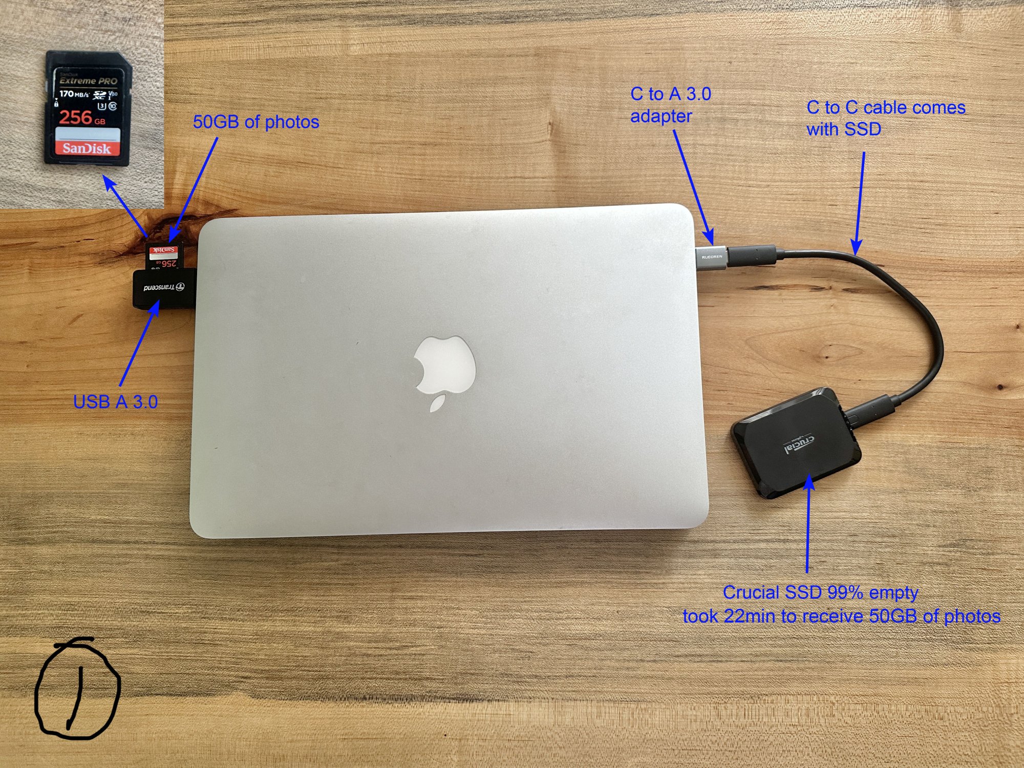

I was transfering 50 GB of photos to two different portable disks via a 2014 MacBook Air. And I can’t believed transfering to my newly purchased Crucial SSD took almost twice slower than transfering to my 6 yr old Seagate HDD. SSD was 22min and HDD was 12 min. I tested twice and consistently same result. Being a tech noob, I suspected it could be cable or connectors issue. Here’s the data
1) MacAir USB port A 3.0
2) HDD has USB 3.0 Micro B connection on the disk side, the other end is USB A 3.0.
3) SSD has USB C on the disk side. It comes with a cable with both ends type C. So I used an adapter USB C to USB A 3.0 for MacAir side.
4) Same SD card reader was used during both transfer with USB A 3.0
Where’s the problem. Can someone advise pls. Tks

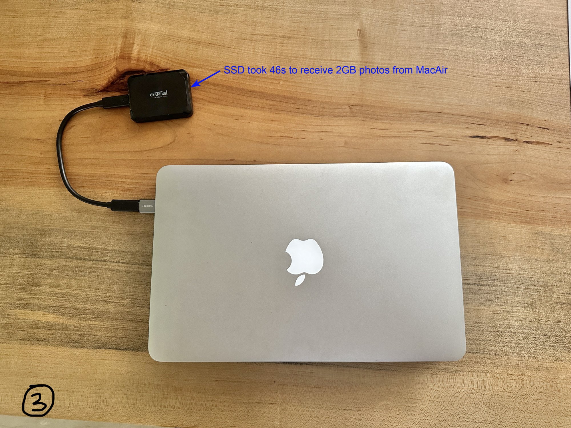

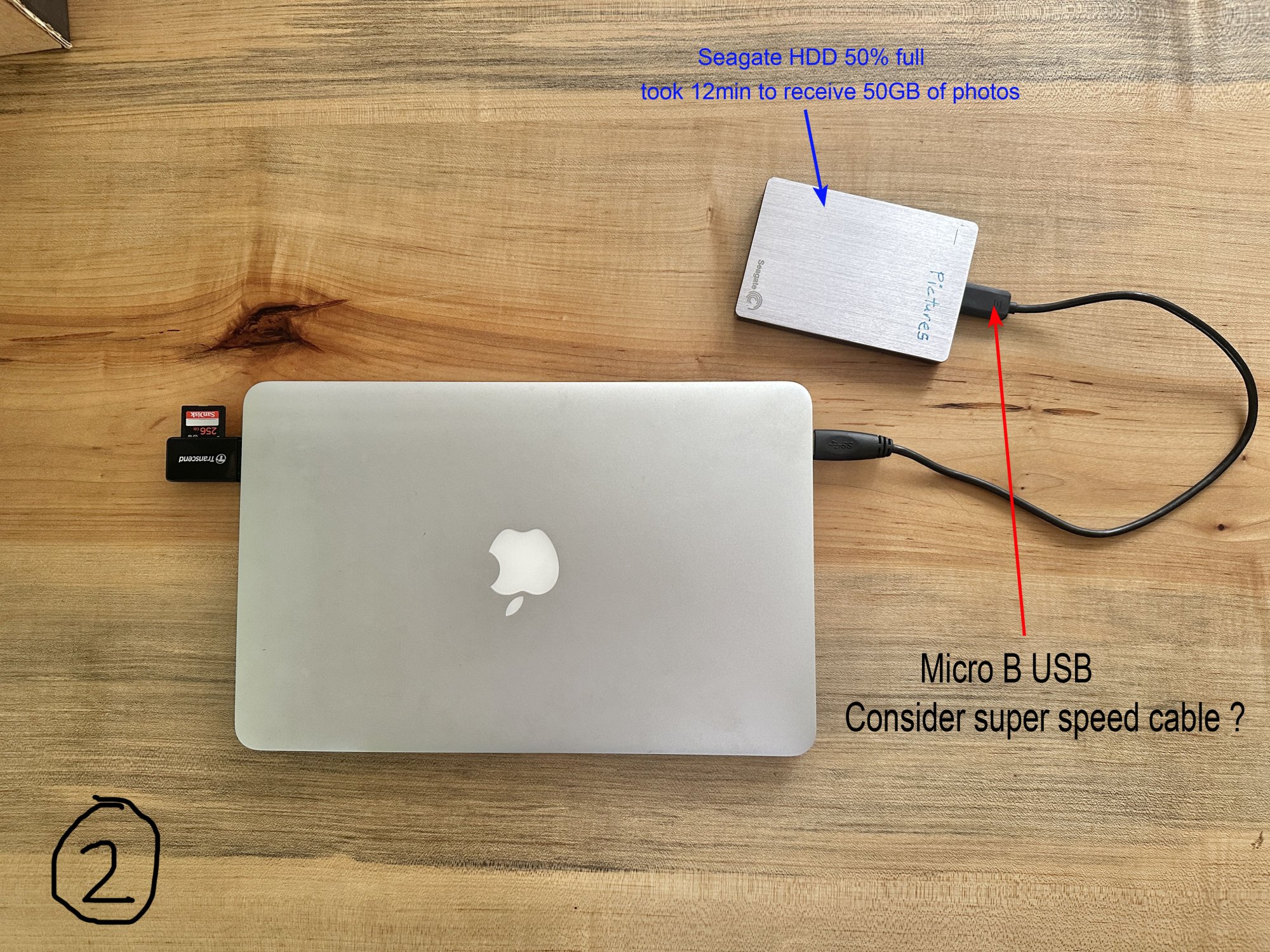

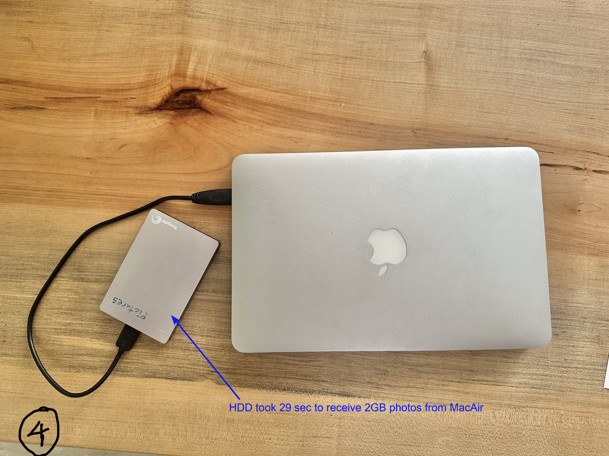

Thank you so much for all the responses. For clarity, here’s two pictures (1 & 2) to reflect what I have done.

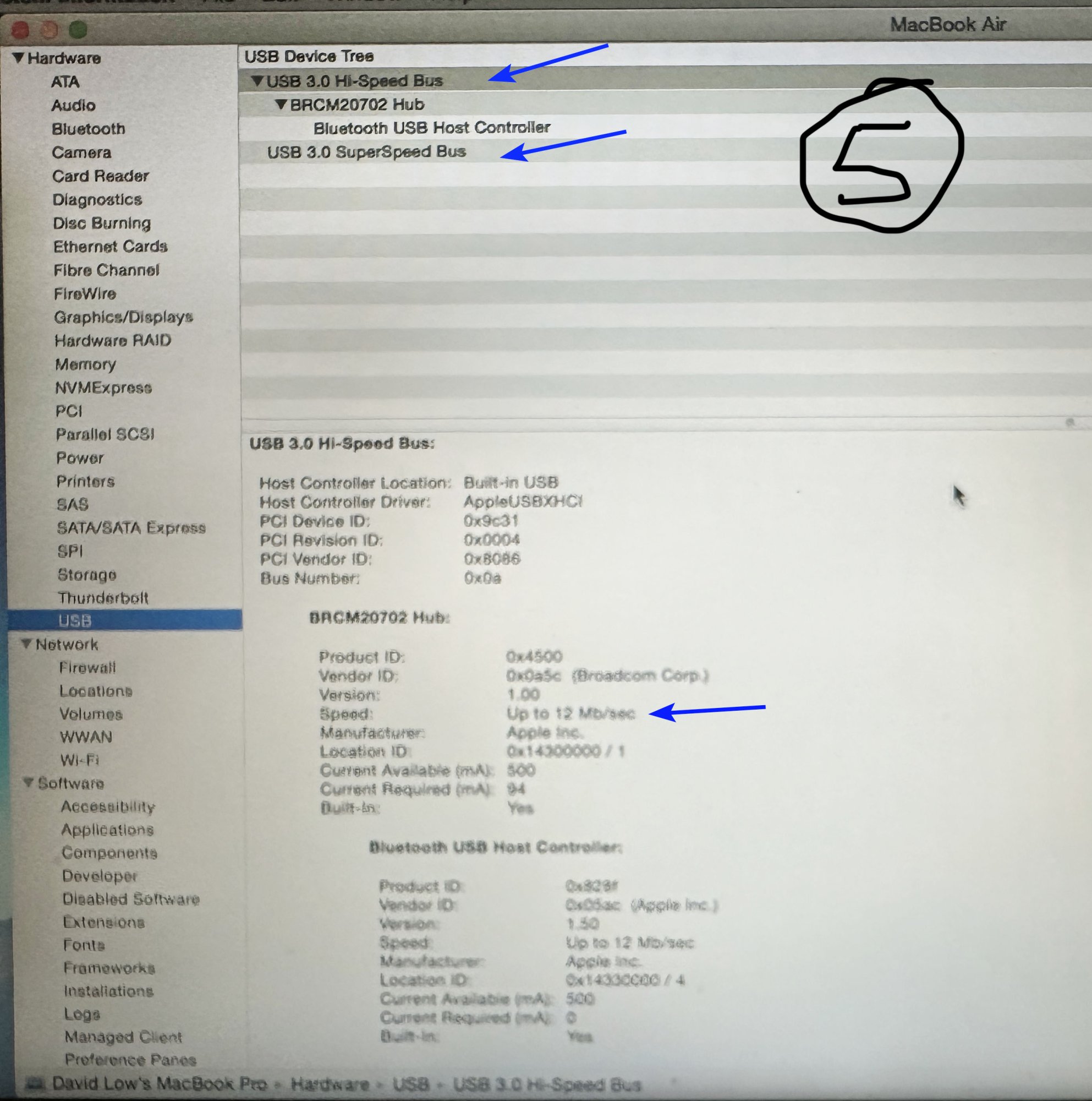

The USB info stated two USB types (photo 5). Speed is 12mb/s. My iMac is 480 mb/s. I called up Apple to ask why such a big disparity. He confirmed my MacAir both left and right ports provide the same speed and is not 12mb/s. Otherwise it would hv taken 1.25 hrs to transfer and is clearly not the case. In fact I hv transferred the same file fr SD card to iMac and to MacAir and the latter took lesser time, probably because MacAir is SSD drive and iMac is Fusion drive. But this not the main point of discussion.

BTW, I just did another experiment transfering 2GB (not to waste time using 50GB) of photos directly from MacAir to the two different disk. (photo 3 & 4). Again it showed HDD is faster than SSD (46s against 29s)
One last thing. The HDD cable is micro B. Some articles said micro B is known as superfast cable. Could it be micro B cable become faster than C cable? Personally I can’t believe it’s the case. Either the C cable that came with it sucks. But I also think that native cable should be almost always the correct one since it’s a branded SSD.
From my 2nd experiment, does it affirmed the choke point is the C cable and/or the poor quality of the adaptor?

Now that's a lot of information, thank you for being thorough! That said, the 12Mbit/sec in photo 5 are not for the SSD or HDD, it's for a Mac-internal USB hub that connects a USB 1 Bluetooth controller to the USB 3 bus. Can you find the SSD somewhere in the device tree? It should have "Crucial" in the string for the Vendor ID.
Micro B comes in two variants, the small one that does up to USB 2.0 speeds (480Mbps) and the wider, two-part one that is USB 3 (5Gbps). A USB-C cable can be anything from USB 2.0 speeds up to USB 4/Thunderbolt 4. I agree that the cable that came with the SSD in 2024 should not be a slow USB 2.0 cable, that would be weird and crazy and stupid.

Are you sure, that the USB-C to USB-C cable you are using came with the SSD?
There are USB-C to USB-C cables out there which are only built for charging. They will only give USB 2.0 speeds during file transfers.
USB 2.0 speed is about 40 MB/sec, which would match your "50GB in 22 minutes"
Have you tried another USB-C to USB-C cable?
EDIT:
Where did you get the USB-C to USB-A adapter from? Are you sure it is USB 3.0? (The blue color inside the plug can be misleading too. It might only refer to the power (wattage) of USB 3, not to the transfer speed.)
Others have suggested buying a quality USB-C to USB-A cable. I would like to "+1" this suggestion. Good luck!
