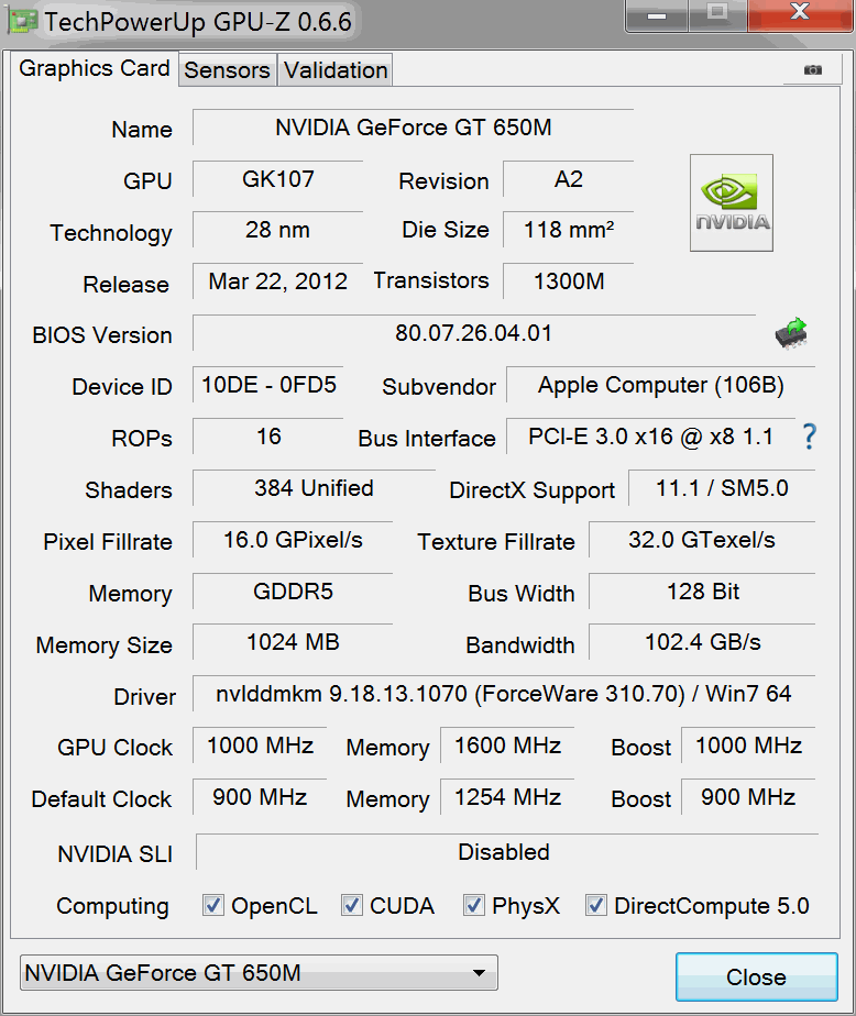

Every 660m I'm aware of runs at 950 core (through boost)
650M in the rMBP doesn't need boost...
Default clock is 900MHz. It's only 50MHz slower than the 660M in retrospect, and if one is willing to push, it can still be faster. Plus GDDR5 clocks are pushed slightly higher than 660M by default.
Apple really pushed this chip to make it at least comparable to 660M.
The 660m can be overclocked too.
All im saying is that the 660m is a better binned chip. If you push it, it will on average perform better than the 650m. 4 mhz on memory doesn't make any difference considering that the 650/660m cannot even use all the bandwidth it has. The desktop 650 ti has the same 128 bit bus and gddr5 at 1350 mhz (but 768 cores at ~950 mhz) and it is a good 50% faster than the 660m.
I have a 660m and i pretty much run it at 1058 mhz (max overclock without bios mods).
All apple did was set default clock speeds to boost speed and bump that up to 900. Which pretty much any regular 650m can do.
If you really want to compare them that much, try a 3DMark 11 run. Here's my rMBP at stock:
http://www.3dmark.com/3dm11/5545137
And here it is after overclock:
http://www.3dmark.com/3dm11/5545265
Stock: 2609 Overclocked: 2878
It's about 10% improvement.
Looking at the average score of the 660M on NotebookCheck:
http://www.notebookcheck.net/NVIDIA-GeForce-GTX-660M.71859.0.html
The stock 650M of the rMBP is about on par. Or are you saying somehow yours is above average?
Also stock 650M on Notebookchecks is well below that of the rMBP by a good margin:
http://www.notebookcheck.net/NVIDIA-GeForce-GT-650M.71887.0.html
So I don't think Apple simply brought the 650M up to its boost speed.
