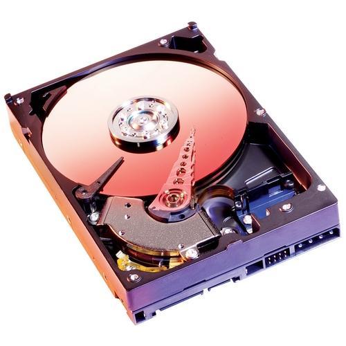

I didn't bought it from NewEgg, but from Best Buy. I don't have the Hard Drive anymore so I can't take a picture. Unless there is a different between a WD5000KS and a WD5000KSRTL that make it not compatible with the Mac Pro. I'm so lost there is too many model.
It look exactly like this. I'm looking to buy a retail version of the Western Digital WD5000KS, I think their newest generation which have whisper quiet operation. I buy a Seagate Barracuda 500GB from NewEgg and it was very loud it annoy me so I return it.

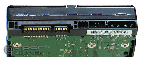

I am saying, given the model number, that is the picture Newegg has and the picture shows no IDE. Again, the second picture also doesn't have IDE.
Did you plug in everything? As in, only one power and SATA? There's two power ports on that hard drive, the 4 pronged one on the right of that pic, and the one that looks slightly longer than the SATA one that's to the left of the SATA port in that picture. Only plug in one, not both, otherwise you risk damage to the drive.
As in IDE Interface, I mean the 4 Pin. I don't think it call IDE though, it look more like a power adapter that go in there. I just put on four screws on the metal plate and slice it in. I thought it would just work like that.
Actually that's not IDE, that's the legacy Molex power connector.

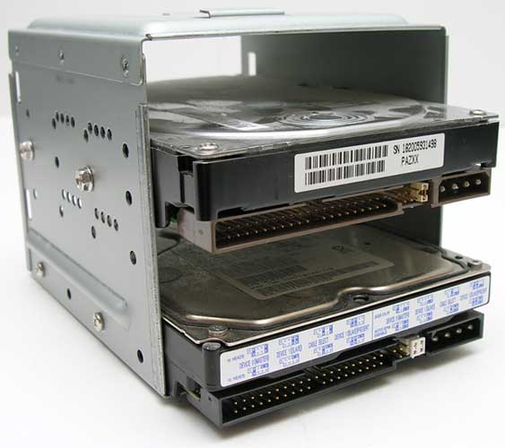

IDE looks like

What you see on that hard drive is just a 4-pin "molex" power connector, which allows you to power the SATA drive from the molex type power cables found in any system that was originally designed to use IDE drives. This is useful for older computers that have been upgraded with a Serial ATA controller card, because the cards usually don't provide an SATA power connector. They just have the SATA data ports, and if the drive doesn't have that optional 4-pin power connector you have to use a molex-to-SATA power cable adapter.
