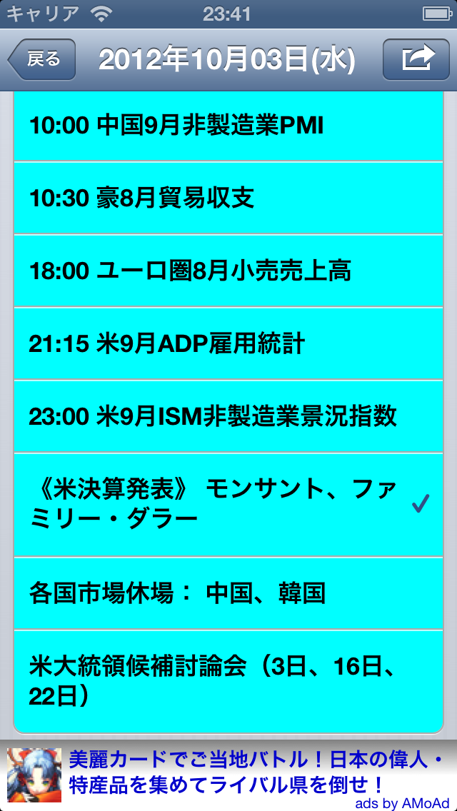

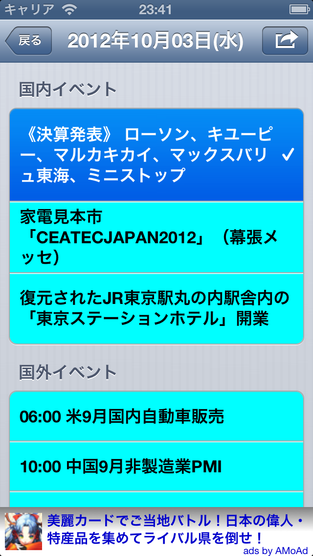

I have a grouped UITableView, and I used code as below from Apple to toggle check mark on when selected cell, but I found there are two cells showing check mark, I am not sure why, how can I avoid this issue?
Code:
- (void)tableView:(UITableView *)tableView didSelectRowAtIndexPath:(NSIndexPath *)indexPath {
    UITableViewCell *cell = [tableView cellForRowAtIndexPath:indexPath];
    if (cell.accessoryType == UITableViewCellAccessoryNone) {
        cell.accessoryType = UITableViewCellAccessoryCheckmark;
    else if (cell.accessoryType == UITableViewCellAccessoryCheckmark) {
        cell.accessoryType = UITableViewCellAccessoryNone;

Maybe my question is not so clear. I need multi check marks if I touched different cells.
My question is that I just touched one cell but two cells will show check mark, when touch again, two cells will not show check mark, does it make sense?
