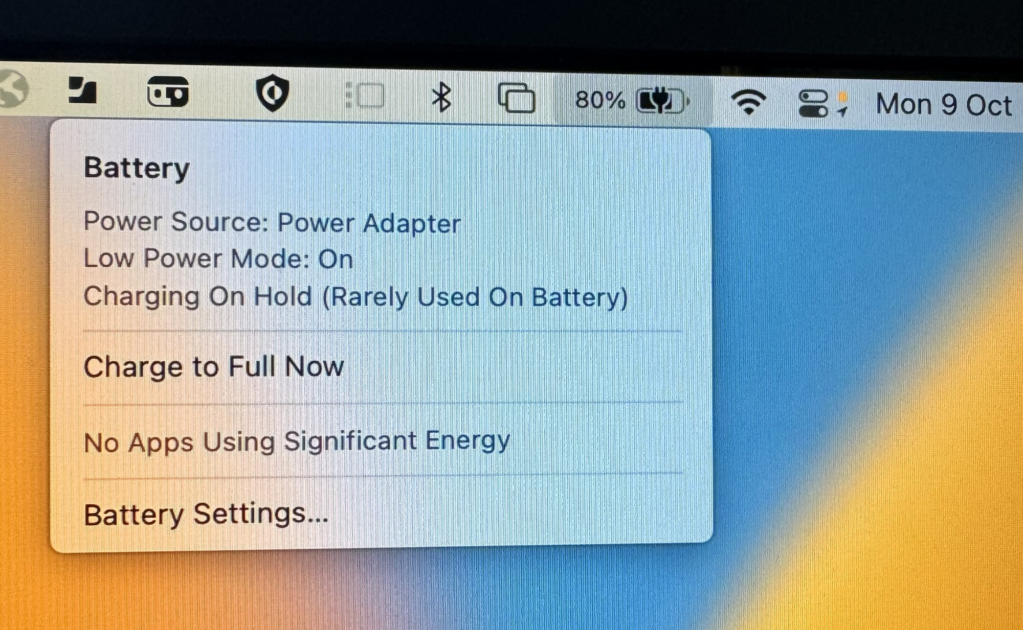

As an aside, my MacBook Pro 14" has been held at 80% charge all-day today - it mostly lives on my desk connected by USB-C to monitor, though tomorrow I'll be away on business for 24-hours and hammering it away from mains power.

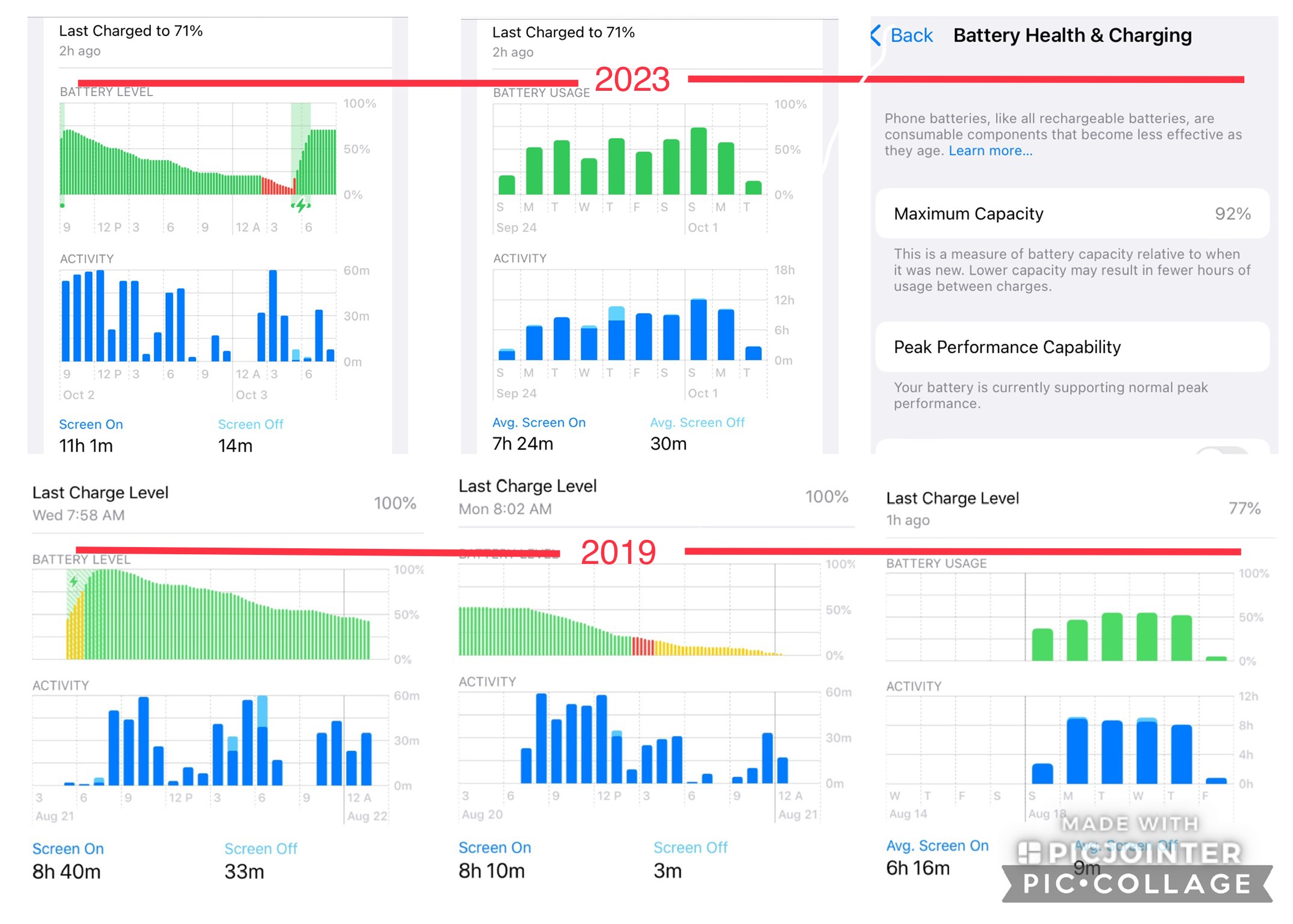

500 cycles > 80% is merely a li-ion standard for LCO chemistry that most consumer devices use, AND assumes the batt is charged to 100% every cycle. Credible/corroborating scientific battery research (I linked a few in a post above) show how cycle life can be greatly extended by avoiding high states of charge.
If a user requires over ~70% capacity (incl cushion) on a single plug-in per day, then there’s little spare capacity within which to conveniently manage a battery. So in that case, I’d also recommend batt swaps and phone upgrades, rather than the hassle of a 2nd plug-in per day, just to save the battery.
That said, there’re plenty of (if not most) folks that require less than 2/3rds batt/day (like me), and therefore can conveniently manage batts on a single plug-in/day. And with current automated options for charge optimization (ie, smartplug/shortcut, or this peak limiter), there’s really no need to worry, hassle, or tend the process anymore - ie, just plug-in once/day and forget about it.
Been doing this for over a decade, and my previous iPhone5 batt had no problem outlasting it’s iOS upgrades, and my current XR (on a smartplug/shortcut) is on the same track as well:
