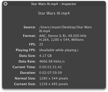

Anyone want to hazard a guess as to why this wont play on my ATV?
Is it because its over 4GB?

Your screen resolution is too high for videos.

You actually could do that resolution at 24 fps, I believe with an H264.
I dont think its the res because I have other stuff at higher 1280x720 that works and it is 25fps.
My guess is it is too big which is really going to piss me off because I will have to transcode the bugger (again) and lose some quality to make it smaller. I've already trimmed bits of the edges to bring the filesize down.

Huh? Trimming the "edges" won't bring the file size down, only reducing the bitrate will. If the > 4 GB is an issue make sure you encode it as a 64bit mpeg 4. Also if it has a. an ac3 dd soundtrack and/or b. chapter markers, then change the extension to .m4v (which I really advise for any atv content).
Your bitrate is very close to the atv's 5mbps limit, in fact there could be bitrate spikes that won't allow it to transfer even though the qt info window is showing an average bitrate of 4666.98 kbps, though I do not think thats really the cause.
Easiest thing to try first is change the file extension to .m4v.

I was using QTPro but it looks like I'll have to do a full transcode and reduce the bitrate somewhat so I'll be bunging it in VisualHub when I can be bothered. One thing I hate about the ATV is its crap handling of files and the strict limits on filetypes. I have spent much more time processing files than I have watching them. 🙁
Thanks for your replies. By the way changing it to .m4v didnt work either so (although I'll do that everytime in the future) I think its the bitrate and/or filesize in this case. Best thing to do, even though its a PITA is another transcode at lower BR. 🙁
The 4GB limit would kill it all by itself.
