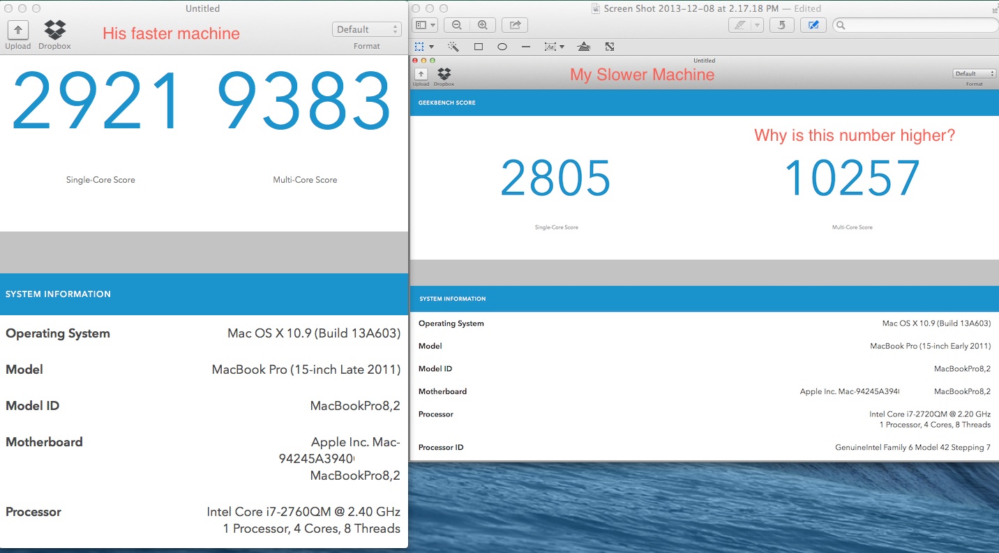

My son and I both have 15-inch Macbook Pro's. Mine is an Early 2011 and his is a late 2011.
He has been complaining that his machine was slower than his friend's similar machine and I told him I assumed it was software. He said I was wrong.
I installed a fresh version of Mavericks on an external Thunderbolt drive and ran geek bench 64 bit on his and mine started from the same fresh install, external drive.
We both have 16 GB of RAM, but his is faster (1333 vs 1600). He has a faster Processor (2.2ghz vs 2.4ghz same gen) and he has a better GPU (6750 vs 6770 both with 1 gb).
He gets better single processor speed, but I am getting better multiprocessor speed. Seems like his machine is about 10% slower overall.
Anybody able to explain the these results?

If you click the images, you can see the processor types. They are both Quad core i7's of the same generation. Heat might be a part of it, but these machines were both cooled down before testing and it seems unlikely to me that heat would be a factor that fast (the test is less than 2 min and only gets the fans spinning for like 45 seconds). I'll see if I can get the heat info though.
Looking at geek bench's website, seems like maybe 5% of people with the same machine have similar performance. Could open the machine and use canned air on it and see if it is dust or something if it is hot. I dunno. Just seems weird to have a 10% performance difference only on the multicore.

Early-2011 15" 2.2GHz processor: i7-2720QM
Late-2011 15" 2.4GHz processor: i7-2760QM

So, I zapped the PRAM and reset the SMC.
Then, we were thinking about thermal paste and in a different thread, I found a guy who had pics of his fans filled with dust on the inside where you couldn't see.
https://discussions.apple.com/thread/2764570?start=840&tstart=0
Sure enough a bunch of the airflow was blocked with Dust bunnies. Removed the fans and cleaned inside and the vents behind the fans. (I do wish the guy who posted the photos had just taken out the screws and cleaned those 🙂 )
My son's single CPU performance went up to 3000 and his multicore went up to 10000. Still slightly below mine, but almost a 10% improvement (which in this instance is close enough).
