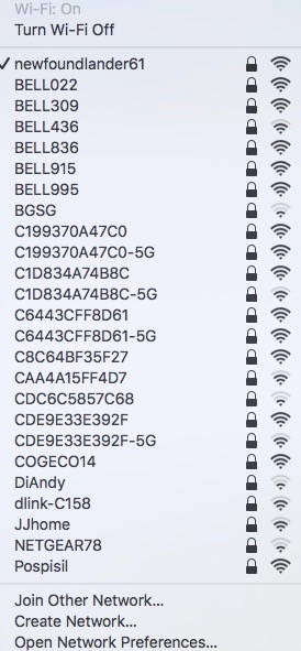

Here are how many neighbours we have:

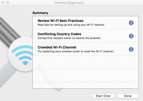

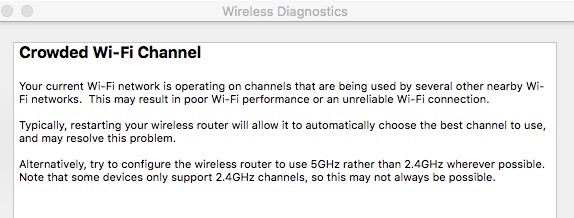

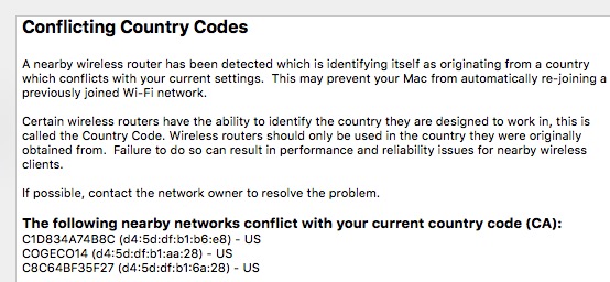

I ran a Wireless Diagnostics and got this report:
Shows my actual connection info:
You are running quite old and very basic AirPort wifi access point. But as it is the n-model already, it supports 5GHz as well, just not simultaneously with 2.4 (as soon as you have a 2.4GHz client connected, everyone is downgraded to 2.4 WLAN).
First thing I'd do - to move to 5GHz WLAN, the ether is still much less crowded there.

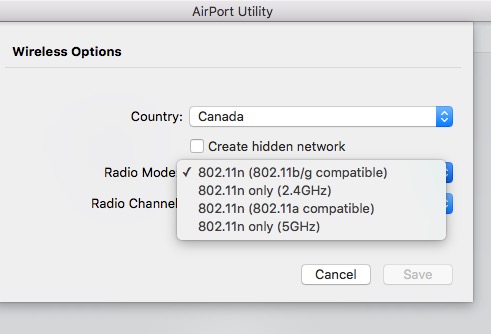

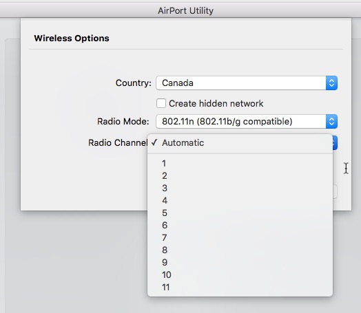

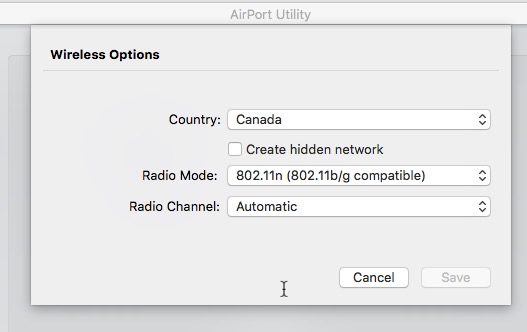

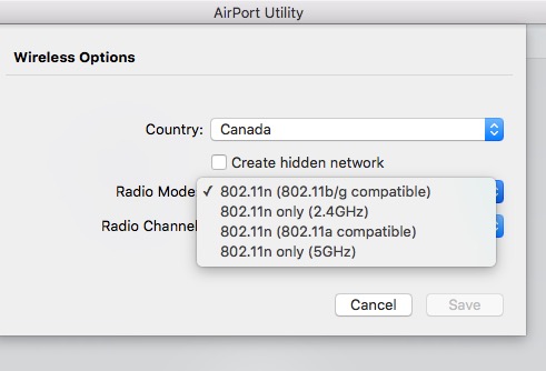

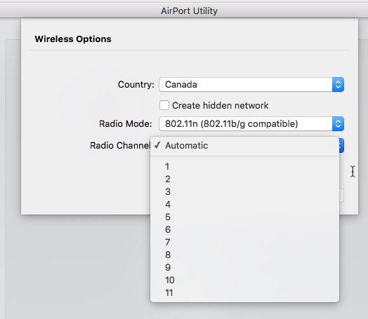

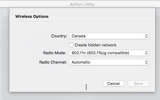

Thanks for all the great info and help. Below is the current setup in my airport express and the available options to change and see if it works. One question is I select a different channel etc is their a chance of losing my internet or will it work as it does now but hopefully a little better.
Current setings in first screen grab
My neighbours are using mostly Ch 11 & CH 1 on 2.4 GHZ, a couple on 5 GHZ
Changing those settings won’t cut you off, just change the way you are getting signal. The following recommendations are general so there are always situations where the exact opposite could be true.
First the radio mode should probably be in 802.11n only mode. In almost all situations 5.0 will be faster than 2.4, but there is one very notable exception. 2.4 penetrates objects better such as walls which could factor into your decision. With that said, I run an Apple TV on 5.0 through two walls and about 12 feet or so and never have trouble (in fairness I have a newer router on a newer wireless standard but the point is the same). I would probably try it on 5.0 for a day and see if it is better, if not switch to 2.4 as it will travel further.
As far as channels, the only thing you are looking for is a channel with the fewest people on it. Macs have a built in utility to check the best channel. Whichever one it says is the best is probably the best in your case. They are all basically the same, just looking for the least crowded.

1, 6, and 11 are the only channels to use for 2.4Ghz. One of the reasons folks don't 2.4GHz is because of how crowded it is. 5GHz is more complicated but usually works fine on "Auto" if it doesn't you should use a signal analyzer to help find a good channel. https://www.maketecheasier.com/best-wifi-channel-for-5GHz-frequency/ 5Ghz won't travel as far, nor penetrate as well as 2.4Ghz does though. The best thing to do is start with a router with powerful antennas. That's why I suggested replacing your tiny/underpowered Airport Epress with a full fledged router equipped with far more powerful antennas like an Extreme.
This is very helpful. It tells us that your Express supports 5Ghz 802.11n. This may be your best option, since APEx does not support dual band, you have to choose.
First question: What devices do you connect to WiFi? Think about everything, Macs (since 2008 or so), ATV and iOS should all be able to use 5Ghz. But if you have home automation stuff, it might not support 5Ghz.
Why is 5Ghz a better choice? It offers more channels, so you may find it easier to steer away from neighboring networks. It has a shorter range, which is a double edged sword. The range might mean less interference from neighbors, but might mean less coverage for your home. Finally, it tends to offer more bandwidth (read that as faster WiFi for larger files or streaming).
Try setting it on 5Ghz and test with a mobile device as far from the Express as you typically use WiFi. Does it have 3+ bars? If so, that will work. Now make sure all devices can connect to 5Ghz. Easiest way to do this is to check WiFi settings on every device, if you can see Newfoundlander61, then you can connect. if you don't see it, the device doesn't support 5Ghz and you will need another strategy.
Once you determine if 5Ghz will work for you, scan for channels on neighboring 5Ghz networks and choose channels that don't overlap.
If 5Ghz won't work for all of your devices, find a new router. if you want to stick with Apple, you can still find AP Extreme\Time Capsule on EBay and other places. the Extreme\TC line on newer models is dual band, so you can have both frequencies. Added benefit is the radio signals are much stronger on the Extreme\TC Line, so you should get better signals throughout your living space. As the list above shows, many of the local WiFi are dual band, you can tell from the Network names being identical with a -5G at the end.
